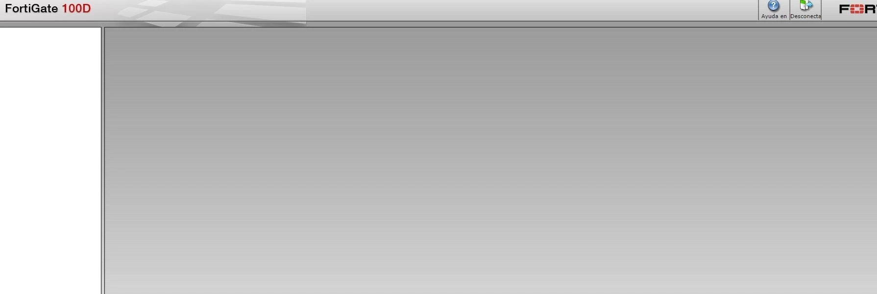

Hi everyone i have a FG100D unit at work it was working ok until some weeks ago i noticed that there are no menus after i log in any ideas Thank you

    Possible your login has been assigned to a profile that has no access rights? Otherwise I would try clearing cache/history/etc and retry logging in, different browser, etc.
    Dave_Hall
    August 27, 2014
    Try to SSH or console into the unit using your admin id -- if you can login ok and access various features, the problem may be related to the GUI stalling/not starting, which can happen if the fgt is running out of memory (aka going into conserve mode). A simple reboot can (temporary) resolve a conserve mode issue. But from the screenshot, it does look like your admin ID doesn' t have any rights at all (just able to log in).
    YES! if you are the owner of the box, someone else might have accessed and changed your profiles permissions. If you are not, consult with the firewall administrator..!

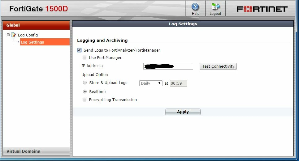

    September 11, 2014
