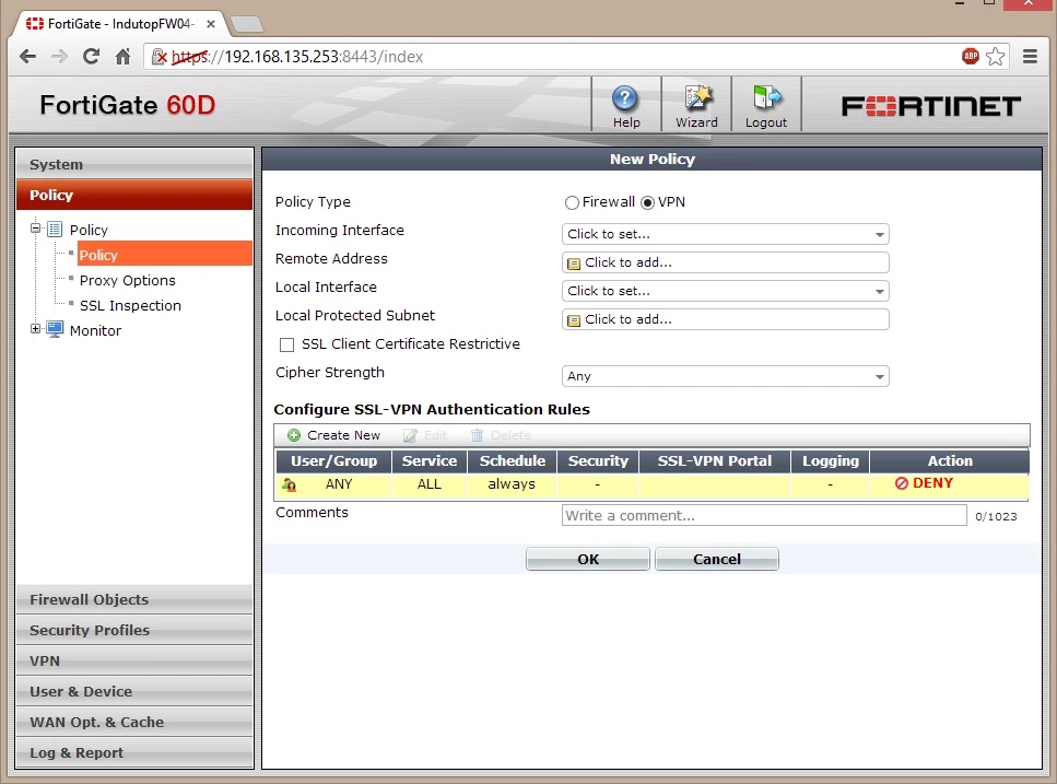

We upgrade our Fortigate 60D to 5.0.4 version, put it in " Interface Mode" and create 2 ipsec vpn tunnels with 2 phases ok to connect to our old cisco router (using dial up vpn) The problem is i cant create the vpn policy for IPSEC, it only show me te SSL VPN options. We have a 60 C with 4.12 with this configuration working ok. Thanks in advance

    hi and welcome, By default, policy-based IPsec VPN is hidden from the web-based manager you need to enable it before: System->Config->Features-> show More-> Policy-based ipsec vpns hope it helps
