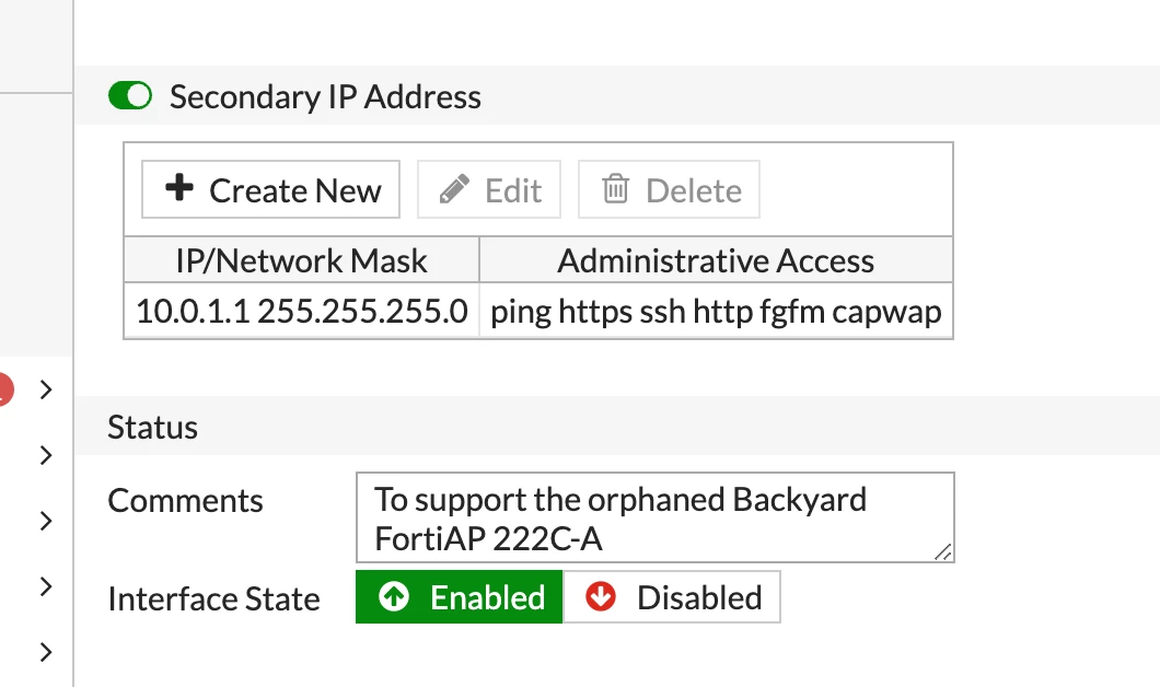

So I was wrong - this did not stop working so recently. It happened back when I was juggling the networks to satisfy a condition I never planned for - We had to move our of our house for repairs and in the temporary place there was AT&T instead of Google Fiber.  They have a requirement to hold on to these 10. addresses on the public side of the modem/router.  So I had to change the IPs of the devices I took with me, and consequently do the same thing for my home network (change from 10.0.1.1/24 on LAN to 192.168.1.1/24).. Apparently, everything changed except for that one FortiAP and now it’s an orphan:
But when I go to visit the web interface, I see that though I believe I have the right uername/password, I’m not allowed to log in that way.  My hope then is that the Fortiwifi can still do so…
So then I need to have a valid 10.0.1.1/24 network on that lan without disrupting 192.168.1.1. This is a home network and I’m Ok with that.
I found this article: https://community.fortinet.com/t5/Support-Forum/How-to-have-multiple-subnets-in-1-lan-port/m-p/201621
This worked, and I did need to do the changes recommended at the command line (Fortiwifi 60D v 6.0.9). In my situation I believe I can add only one from the GUI, which I do.
I end up with the following:

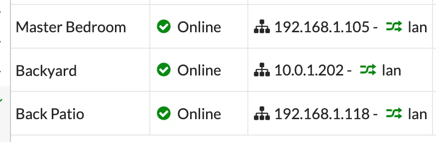

And under Managed FortiAPs - success!:
I next will try to see if I can get some clients to join and also to change the IP address Backyard gets so that I can have them on the same subnet. I have no need for an additional subnets on the same physical network without VLANs.

Status from the previous reply to which I was not able to attach the screenshot.AP is onlineAP is online

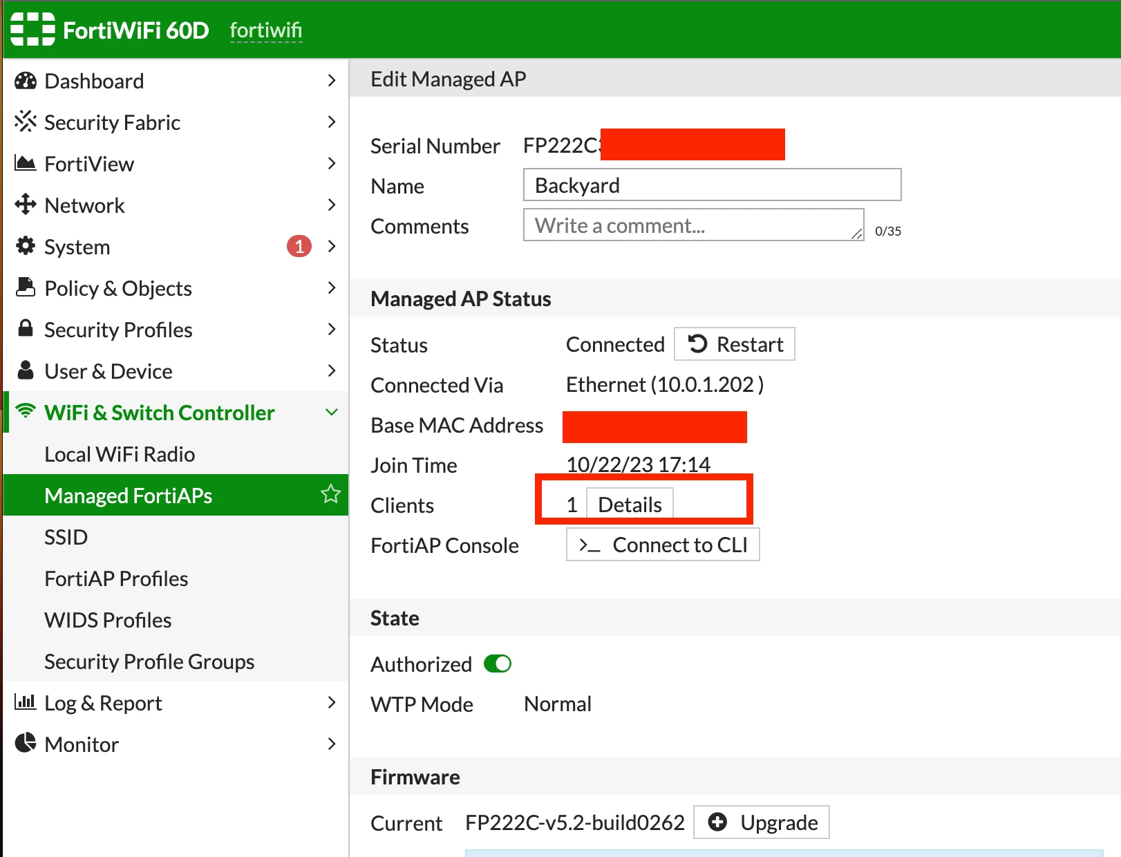

OK, I did get a client to join the backyard AP after I added one of the SSIDs to the 5Ghz radio. The iPhone I was using was preferring the further away 5GHz to the nearer 2.4GHz.
The last thing I need to resolve is how to administer the Backyard FortiAP 222C-A so that I can set it to DHCP its IP address. I do not seem to be able to ssh to it (connection refused) or via web, a put "admin" for user and password as blank or as "admin" and the top banner displays for a split second then drops back to the login. Any ideas for how to resolve this? Do I need to get the POE injector with the reset button? If so what is the model or SKU so that I can find it? Any other tips?
Has clients now as can be seen below.
