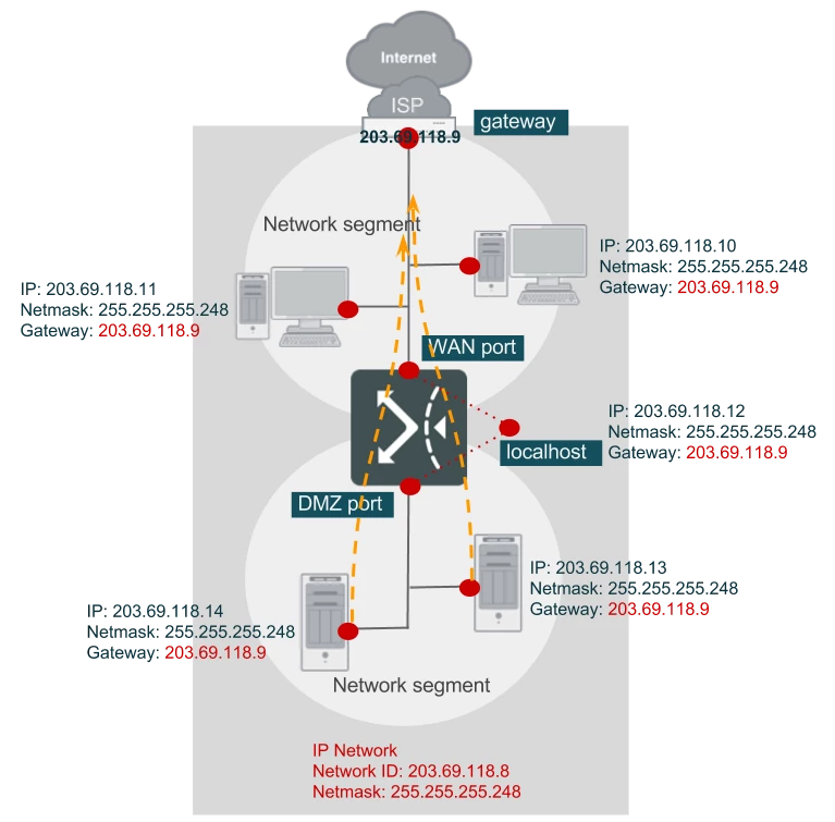

When I started to fight with this problem I’ve found this diagram
And this is how I wanted to work, but I think this scenario is only possible in transparent mode of forti.
My forti is working in NAT and of course I can’t change it.
What do you mean that device must be in the same vlan as ISP router? - this could be only possible if I put switch between forti and ISP, right?
My physical connection is the same just like in the picture: I have two subnets on WAN and I want external IP on the port of forti, whatever which one.
funkylicious
September 14, 2026
yes, adding a switch between ISP and FortiGate WAN would help, all the devices would be in the same VLAN/segment
connecting other devices to another port on the FortiGate would break this segment when running in NAT.
you could create a software switch where you add the WAN and DMZ, in your case, which will create a ‘switch’ but will requre reconfiguration of the rules/objects/routes and others bound to the WAN so a real switch between ISP and FGT would be the way to go.
