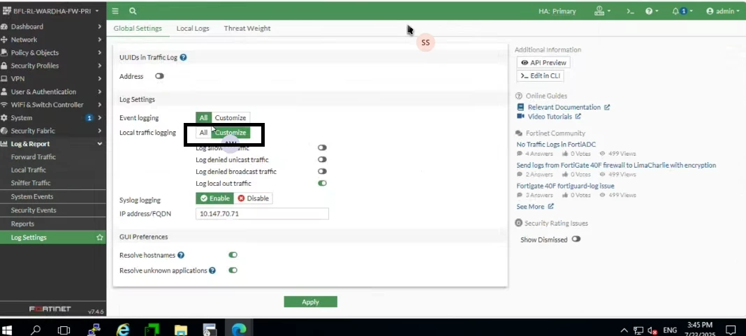

Need command to activate syslog local traffic logging through fortimanager.

We have 242 devices we need to enable local traffic logging option of syslog through Forti manager.

We have created the script & its working ,but we need to enable local traffic logging option of syslog I have marked specific option in image which we need to enable.

The CLI to get that setting you showed in GUI is:
config log setting
  set local-in-allow disable
  set local-in-deny-unicast disable
  set local-in-deny-broadcast disable
  set local-out enable
And you could push this via a script or CLI template. But changes made by script might not stick when you swap the hardware with a new one. I recommend CLI template then sync it with both device DB and remote device config.
However, I believe this setting is default values after factory reset. Isn't this set already at those FGTs you manage?
