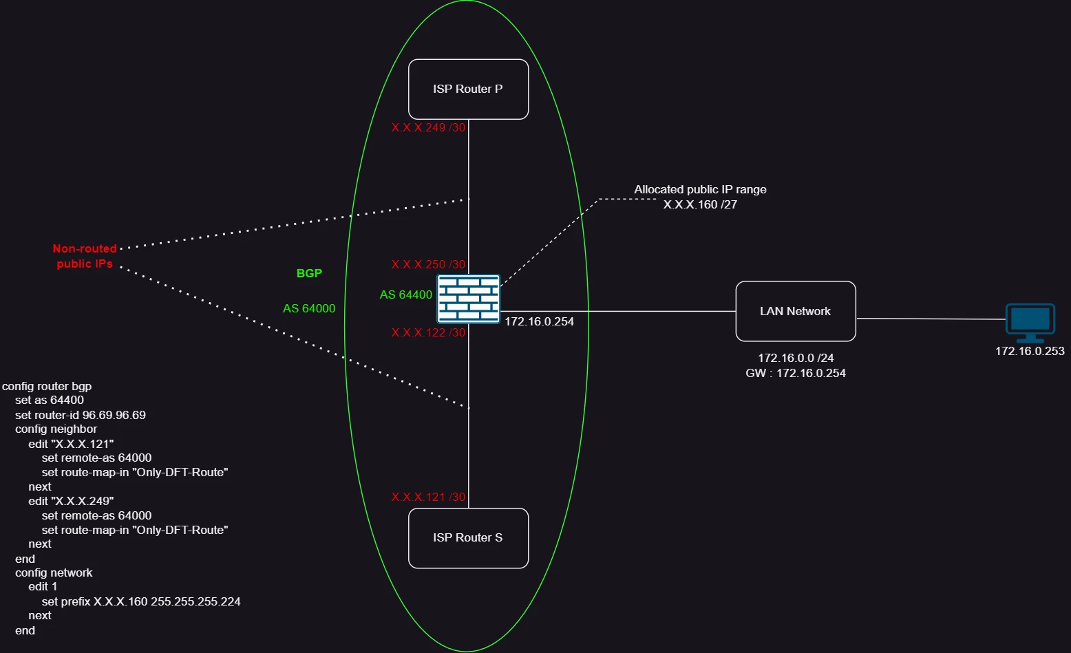

Hello guys,
I'm new here and I'd like some help with BGP and public range configuration. It's the first time I configure both.
Info :
I have a new setup with one ISP with two connections (Two routers), a primary (10Gig) and a secondary (4Gig).
- Both are connected to a Fortigate 1000D.
- A p2p public IP to both routers with BGP configuration.
- The p2p IPs are non-routed IPs.
- A public range /27.
- Only the default route is shared by the ISP.
I would like to know what's the best way to configure the public range to avoid limitation?
Just to try the connectivity, I have tested this right now => Set the Public range with loopback interface. It works, but only the first IP is available of course. Also, I realized that I can't use the loopback in local out routing for the DNS/Fortiguard.
I also tried to set a loopback with a /32 and did the same with the BGP network command, but even if it's shared to the neighbor, I lose internet connectivity. Maybe it's normal with BGP, but I don't get why?
Here is a schema to help you visualized :)
If there's not enough info, just ask ;)
Thanks!

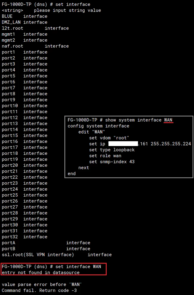

for most services you can set from cli, set source-ip although indeed from the GUI a loopback interface cannot be selected.

I tried to use the loopback interface in CLI but it doesn't show up. I even tried to force it but it doesn't work:
