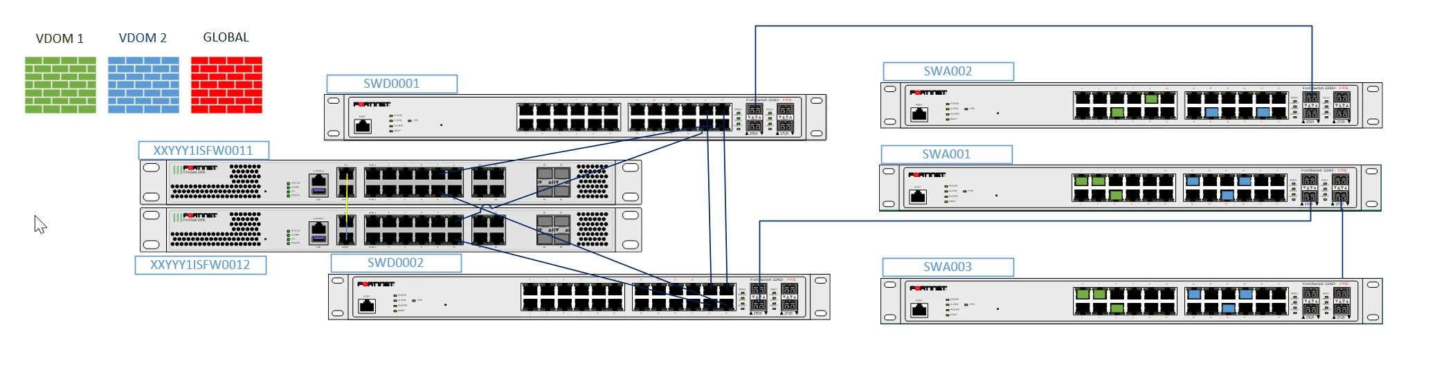

    Hello
    I know this is very very old topic but I have to create something similar. The goal is to create infrastructure base on the FGT and many FS with 2 or 3  vdoms and distribute vdoms across this network. On the and I need assign part of the ports on every switches to different vdom, Is it possible on os 7.2 ? How to do this .
    Concept
    For any help, I'll be appreciated.
    Even if it will be confirmation from Fortinet - "no it is not possible" :D
    Translate
    Toshi_Esumi
    Apr 12, 2024 7:02 PM UTC
    I could be wrong but if you "manage" FSWs from a FGT over fortilink, the FSWs are managed at the vdom the fortilink is terminated at. By default "root" vdom. Then all ports and VLANs you create from the switch-controller at the FGT specifically at root vdom would belong to the root vdom. So I don't think it's possible if "managed".
    My recommendation if you have to use FSWs instead of other types of switches like Cisco, Juniper, HPE, or whatever, you configure them as "standalone" then they would work as any other types of switches, except some feature differences. Then you can do whatever you need to do, like setting up multiple VLAN sets and create clusters of ports with those VLAN sets then connect them to FGT's ports per VDOM.
    Wait for other comments that deny my claim.
    Toshi

    Apr 13, 2024 5:17 PM UTC
    I see, then you can. Thanks @AEK
    It would be much simpler if they're standalone though.
    Toshi
