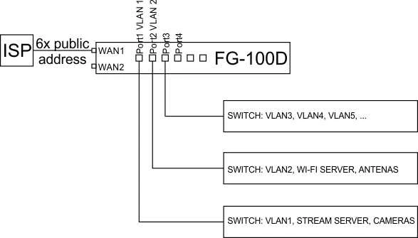

My ISP provider at one port of their equipment provides six public address. How to connect and define the distribution of the addresses at FortiGate 100D OS5.0? I have several networks, of which three of them needs their own public addresses while others need only output at the internet. All networks that need only internet, I' d put at one public address.

    I have 6 public address in the range of x.x.x.122/29 to x.x.x.126/29 and gateway x.x.x.121/29. All public addresses are connected to the FG-100D WAN1 port. I need functionality as if I were directly connected to the router, access from the outside, port forwarding, etc. In this way I should be able to set up access to streaming server. (Wowza) Public address x.x.x.122 going to port1 (VLAN1). Network 192.168.11.0. Public address x.x.x.123 forward to VLAN2 (other device), which is administered by another company. Public address x.x.x.126 should be used for all networks that do not require interconnection, are in different VLANs, but only need exit to the Internet. I hope I have explained better.

    This is a port-forward VIP so only those services are pinhole to the inside. You need to enable NAT on a policy that allows the inside server outbound for all other traffic if required. It would used the .126 WAN interface or build a ip nat-pool and select that pool for the traffic originating from the inside outbound. All traffic that maps the VIP will automatically reply with the vip mapped-ip. Also diag debug flow with filters would help you understand what fwpolicies are used for both the in or out. Do a search here with the above 3 words, for many examples. BTW, your diagram was extremely helpful. I wish more will explain what they are doing via diagrams. This will assist us with give you guidance or direction. Start with one VIP 1st and then build the group later so you get comfortable on the operation, but your on the right track.
