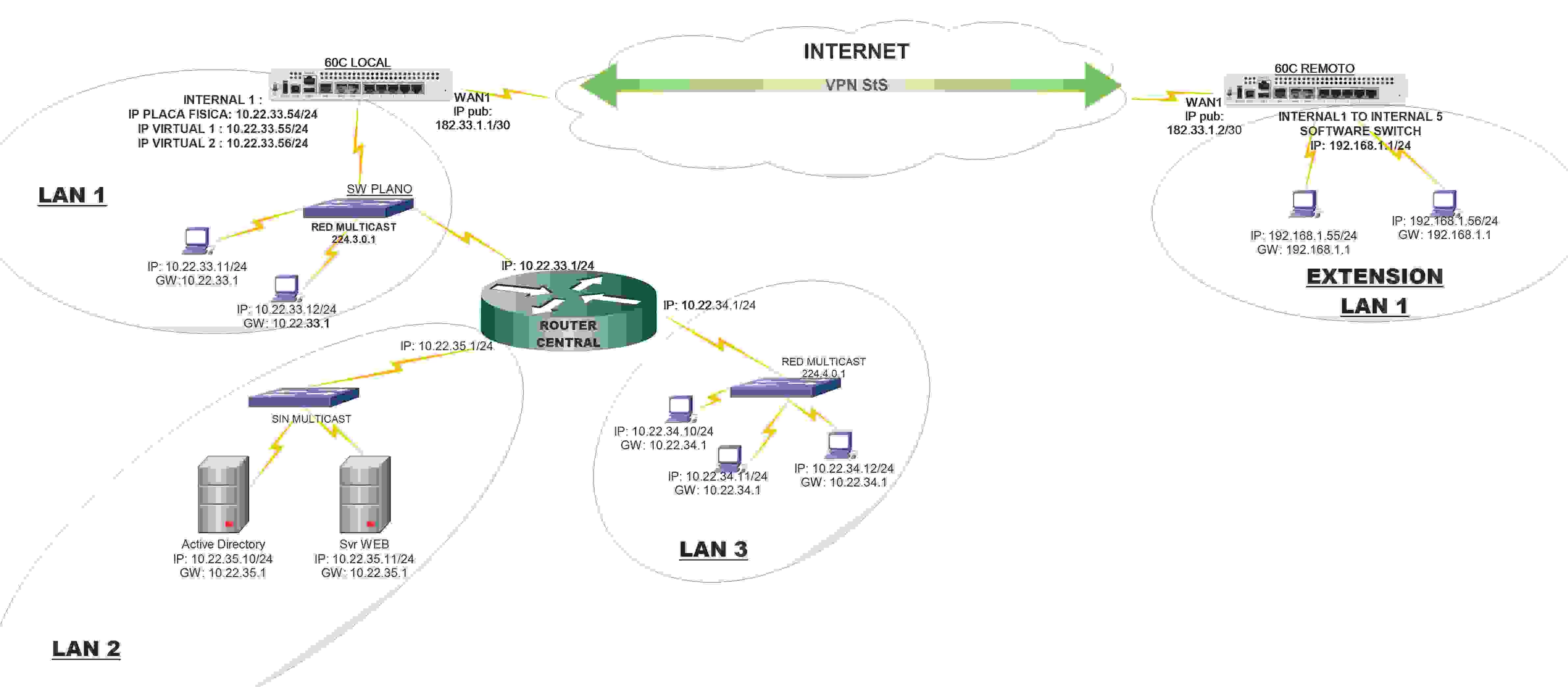

Dear good day. I'm looking for the solution to this problem for quite some time, what I need is to extend a subnet in which there is multicast traffic through a VPN StS. I managed to extend the LAN without problems using virtual IPs and NAT, the problem is that I can not passing the multicast. I need to extend the LAN because I do not have access to the administration of the router that connects the LAN mentioned, and for this reason I force myself to extend it. Shipping diagram of a laboratory that have mounted to perform the tests. The segments are placed IP test, so the structure. At both ends of Sts 60C Fortigate equipment I use.
Deputy config summarized each team Forti my lab and diagram.

config system dns
    set primary 208.91.112.53
    set secondary 208.91.112.52
config system session-helper
        set name pptp
        set protocol 6

I hope excuse my English.
From already thank you very much. Greetings atte. Mario.
