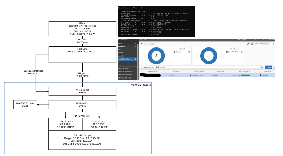

Good day, I am trying to migrate my SSL full tunnel VPN from using an Address IP List (10.0.3.0/21) to issue IPs to VPN users to using an external Microsoft DHCP server, I need to do this as the FortiGate can’t add DNS records for VPN users as it does not support this.
I have set up a new scope on the Microsoft DHCP server 10.0.16.0/21 as shown in the screenshot, my local subnet is 10.0.0.0/21, I can’t use the existing Subnet as it conflicts with the DHCP server.
The issue I am facing is that when I connect to the SSL VPN once I have migrated, I am unable to access any devices on the 10.0.0.0/21 subnet, I updated the Firewall policies to the new Subnet and updated the VPN settings following the Fortigate guide here https://community.fortinet.com/t5/FortiGate/Technical-Tip-SSL-VPN-with-external-DHCP-Server/ta-p/215644.
I noticed that when connected to the SSL VPN the client gets two IP’s for example in the screenshot on my test device I got 10.0.16.5 as my IP and 10.0.16.6 as the Gateway which I don’t understand if the SSL VPN assigns 10.0.16.6 as my gateway what should I set the gateway to in the Microsoft DHCP server?
Also, as I am using a Subnet outside of the local Subnet, I am not sure if I need to add any routing. I have tried to add a Static route for the SSL.root interface but not sure what the Destination or Gateway IPs would be because of the Gateway 10.0.16.6 issued to the client above.

Hi, thanks for the information, so something like below? what ip would I use for the virtual IP "Mapped From"? does it need to be an ip from the internal subnet 10.0.0.0/21?
Virtual IP
Name: VPN Virtual IP
Interface: VPN DHCP LOOP
Mapped From: 10.0.16.1:443 ?? internal IP?
Mapped To: 10.0.16.2:443 (VPN DHCP LOOP IP)

I have been looking over the FortiGate documentation and was thinking it may be easier to assign a secondary IP to the internal LAN Interface "Option B" as creating a loopback interface requires a lot of changes. Would anyone agree with this?
