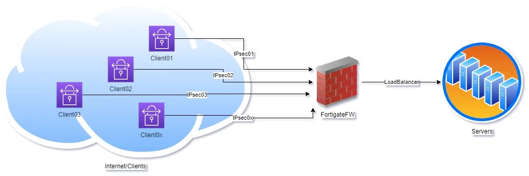

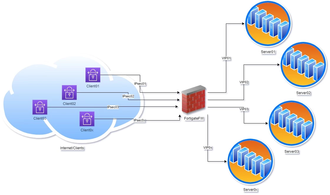

I was wondering how to solve the following issue:
Right now, I have several customers connected via ipsec individually, each one with a different virtual IP to several servers inside my network.
What I want is to transform that into a single load balancer for all of them, BUT, without changing the IP on the client side. In that why I do not have to modify any phase02 on the tunnels, I want it to be as transparent as possible for the clients with a somewhat minimal disruption.

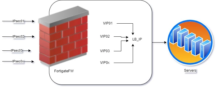

I was wondering if that is possible with a single FW?, and if (please) anyone could give me a pointer for that.
So far, what I was thinking was to create a LB for each client, but, I mean, it doesn´t feel optimal.
Instead, a single LB for all the customers would be more effective.
My issue is that I do not see a way to do it, like, pointing all current VIP to a single LB IP, but all inside the FW.
So far, I do not see it without the need of another FW, and without messing up the client side of things.
Any ideas?

AlexC-FTNT
September 13, 2023
You're correct. As long as all those tunnels point to individual VIPs, then you will need all of the VIPs.
And to use a single VIP will require the clients to point to that one single IP.

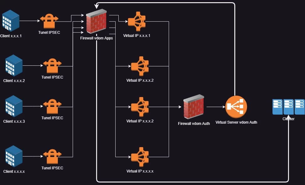

Can the FW do the following while having multiple vdoms?
In vdom mode; "technically"; I could point all the VIPs to a LB in another vdom; right?; and I could do this without service interruption (the firewall already has 2 vdoms).
But the thing is, can the FW software understand all of this correctly? Is not a fancy solution BUT, if it works...

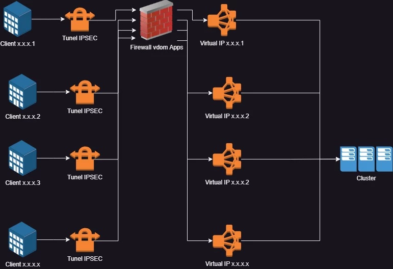

Let´s use graphs again,
The problem:
And what I think could be the solution, using a second vdom:
Is this a valid solution? poiting all the VIP to a virtual server in another vdom in the same firewall?

Hmm, no, in my mind, the solution would be to:
  1. Setup a loadbalancer behind the FortiGate.
  2. Set up rules on it, to allow it to serve the app's in the Cluster.
  3. Make a test VIP with/without an IPsec tunnel and test it works
  4. Move over one VIP to point to the Loadbalancer (in a service window as needed)
  5. Move the rest when allowed.
There should, in my knowledge, be no reason to implement another VDOM for this, unless you have other reasons.
We only have 2 VDOM's (+Global) at our main site, because the inbound SDWAN/ISP connections is moved there.
All VIP's and other rules, are ate the root VDOM.
Hope it makes sense.
