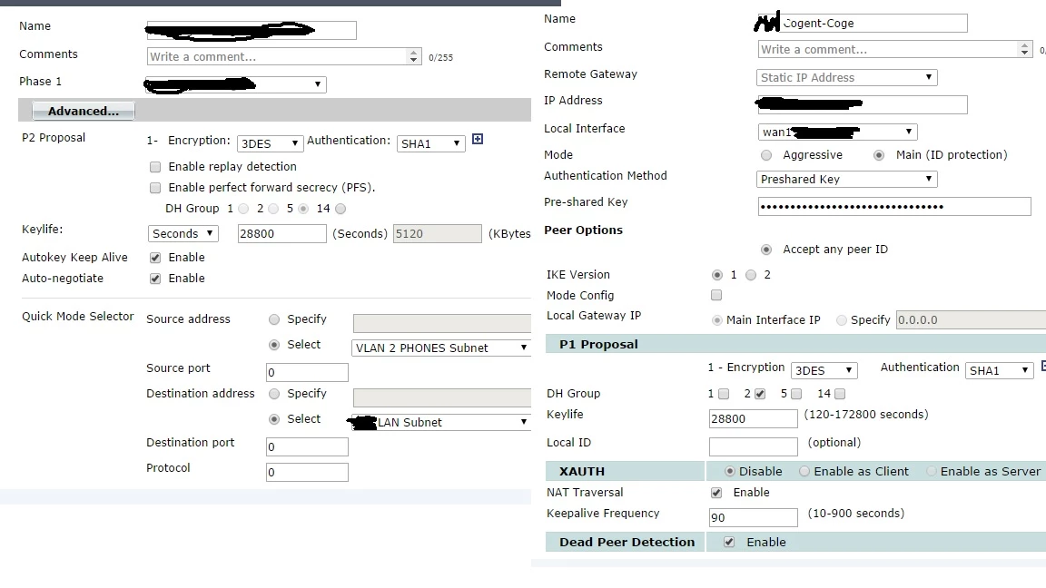

We' ve been having issues where we have our Fortigate connecting to a Meraki MX devices. The VPN tunnels connect and work great most of the time but we have issues where all the Tunnels to the remote Meraki devices stop passing traffic. The tunnels appear up but no traffic passes. If we recycle the tunnels manually they seem to work without issue. The lastest " fix" is was to put in BlackHole routes for the remote sites. Only time will tell if it fixes the issue. Has anyone else had any issues with Meraki MX end points? On the reverse, has anyone had no issues? Brady

    Sounds like auto neg might not be enabled on the vpn interface. What type of vpn did you build ? and no, I haven' t had any problems with Meraki and vpns to Fortigates.

    It wasn' t enabled. Here' s a screen shot of my current setup which is working with the Black Hole Routes. http://docs-legacy.fortinet.com/fgt/html/fortigate-admin/wwhelp/wwhimpl/common/html/wwhelp.htm?context=fgt&file=Router_Static.15.8.html edit 23 set blackhole enable set comment " BlackHole Route (device is not used), CLI Config Only" set distance 100 set dst 172.21.0.0 255.255.0.0
