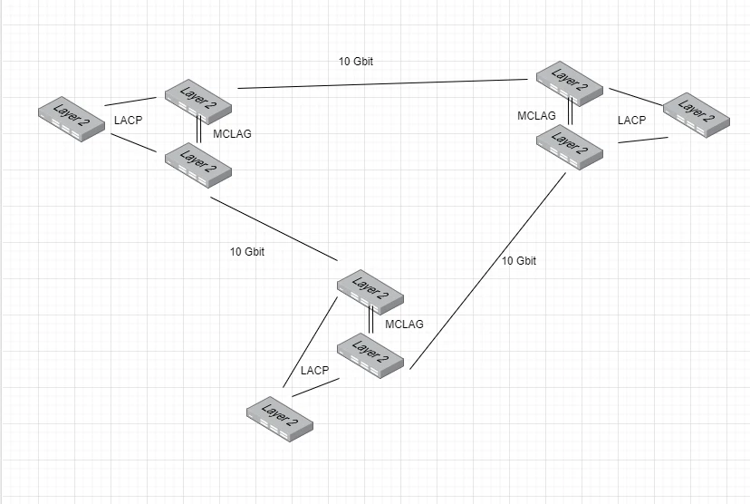

Hi ho everyone,
i try to understand the MCLAG Setup of the Fortiswitches.
I do have three pairs for 524D and 548D Switches which are connected with WAN connections to built up a ring structure for redundancy. Each Pair has the MCLAG with 80 Gbit and MSTP configured.
The MCLAG is configured using the actual documentation and has the global STP awareness activated.
When I will bring additional Switches into this network it could happen, that the STP will breakup the MCLAG.
This will disturbe all other LACP Trunk on the Switch Pairs as the servers or access Switches.
Just tell
