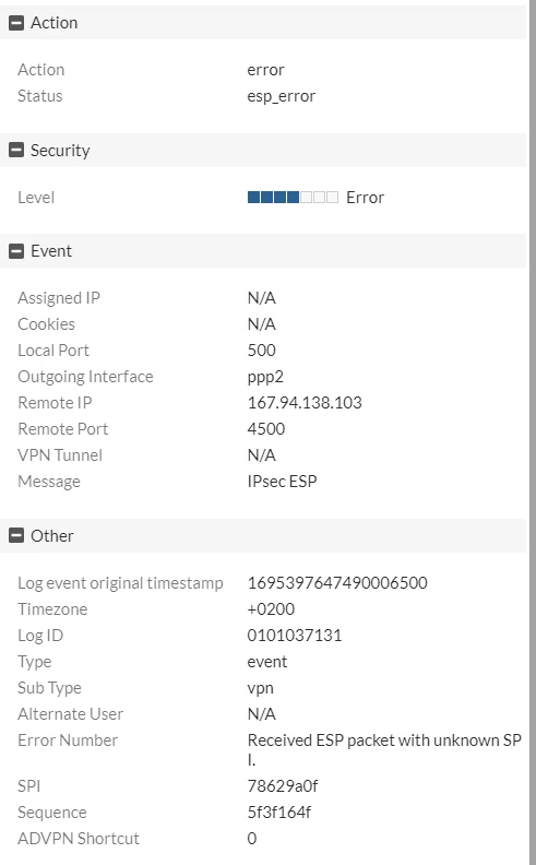

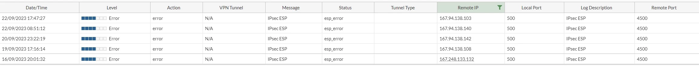

Hi, I have a Fortigate 60E firmware 7.4.1
I have a public subnet that very often tries to connect via IPSEC VPN to the firewall. I therefore created a local-in-policy to deny the connection to this subnet, but I continue to see the logs and I also receive emails from an automation that notifies me of unsuccessful VPN connections.
Shouldn't the local-in-policy block the source connection so it doesn't even create the log?
The firewall navigates with a public IP directly on its WAN.

Hi Abdel, thanks for the reply but what you tell me I think is more of a workaround because if I have a local-in-policy that blocks IPSEC traffic, why is the log created in the VPN events section?
If traffic is blocked on the WAN interface it must not be processed by the CPU. As you can see it is as if the package has been processed. It should be discarded directly.

HI @FortiMax_it
This seems to be an expected behavior because this is not a proposal received from remote peer but an ESP packet with incorrect SPI... This packet is being dropped before local-in-policy by the kernel and iked logs it..

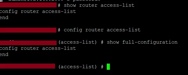

Is you FortiGate support acl? check with the command show router access-list
Abdel
FortiMax_it
Explorer III
September 22, 2023
Hi,
does it support ACLs, yes.
anignan
September 22, 2023
Hi @FortiMax_it
Try to use ACL this may help in your case..
Abdel
