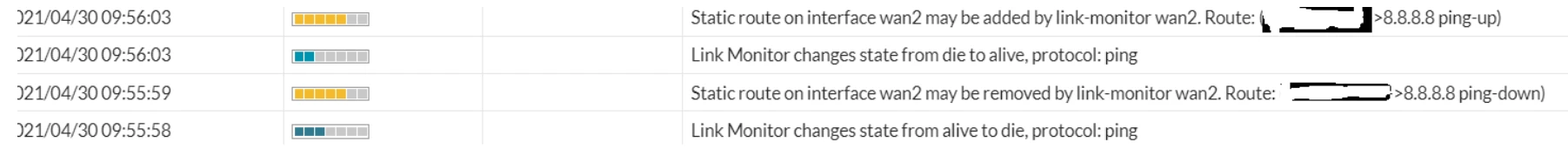

Hi All,
We are getting link monitor changes state logs on FG100D, I am not sure because of this my voice call user are getting affected they are facing drop in call is this because of this? pls find the attached below.
Regards,
Srini

    During the issue time do capture below logs
    diag sniffer packet any " host 8.8.8.8 and icmp  " 6 0 a
    Need to look into the packet drop/delay  in response

    Hi Vasugk,
    Could you try getting the below outputs when the issue happens
    diagnose sys link-monitor status
    get router info routing-table all
