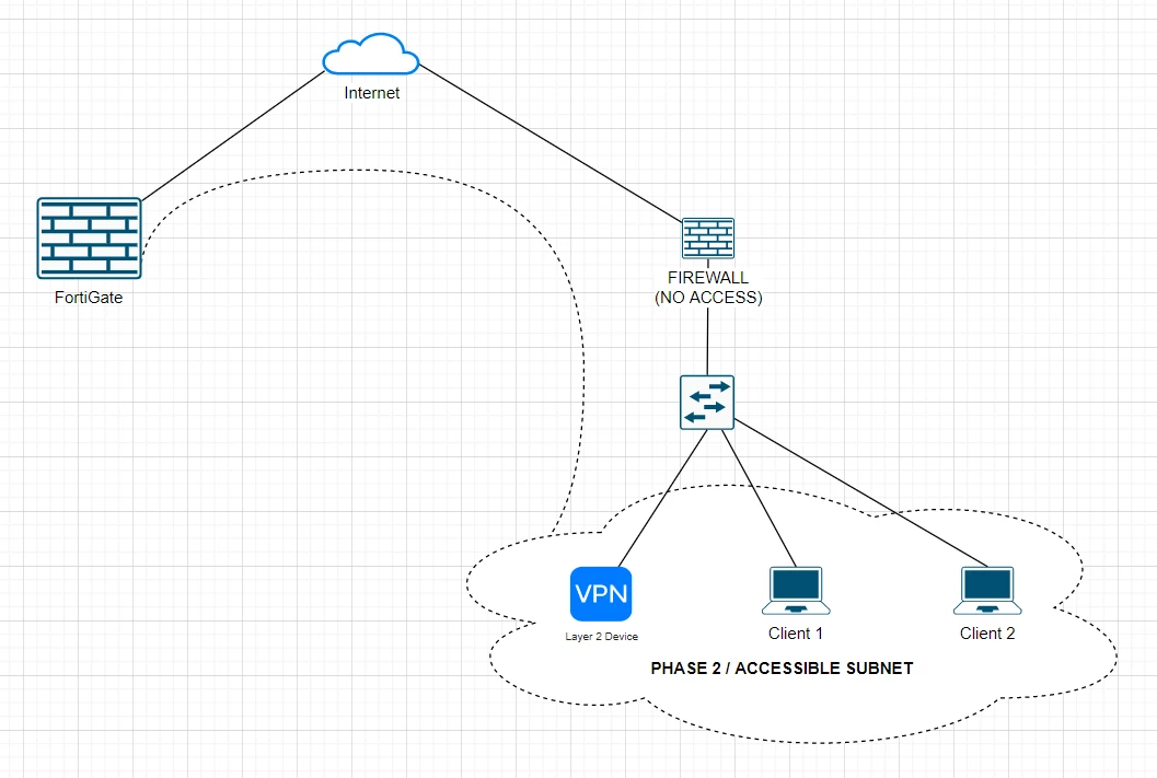

Hello There,
I have a use case whereby we dont have access to the layer 3 device to provision an IPSec connection. Furthermore, the network is managed by a third party, so we cant migrate the LAN to a new Router/Firewall.
This means our only option to gain access to the client devices on the network is via VPN software/hardware tool which is installed as a layer 2 device. This could be Rasberry Pi, Windows Server, Windows 10, Linux etc.
The only Layer 2 Device solution im aware of is the Windows Routing and Remote Access (RRAS)
However, I dont beleive the FortiGate can connect to a SSTP VPN?
Any clever solutions welcome :)
Thank you in advance.

Hey,
you will likely need to know first how either of the two endpoints can contact each other.
Otherwise accessing a stranger network would be rather inseucre.
If you cannot manage the firewall in between you likely cannot do a port forward to the raspi.
You could however use strongswan/libreswan for example to connect to the known IP address of the FGT with a dialup VPN. So connect from inside the network to the firewall.
Example:
https://community.fortinet.com/t5/FortiGate/Technical-Tip-Using-LibreSwan-for-a-site-to-site-IPSec-tunnel/ta-p/197548
