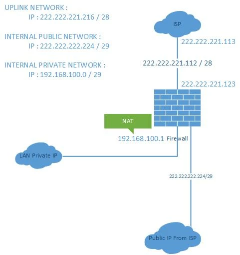

Hi All,
I have a problem with my implementation with fortigate 90D in my office.
My ISP give me /29 public IP to be used for our server, to access the ISP network, they give me another network (uplink network). I also want to create NAT for our staff. Is it possible to use fortigate 90D to accomplish this network plan?
I think it's quite usual network diagram, I already done it using mikrotik, but I want to change the mikrotik with fortigate 90D.
Please give me your suggestion how to configure the fortigate 90D. ( I use interface mode )

    gschmitt
    October 5, 2015
    VDOM in Transparent mode
    effendisusanto
    October 6, 2015
    Thank you for your answer  gschmitt, but I really don't get it at all, how to do VDOM in transparent, would you like to elaborate?
    gschmitt
    October 6, 2015
    Start with this: https://www.youtube.com/watch?v=31MfllV3IwE but set one of the VDOMs to Transparent
    Create a VDOM Link and treat the NAT VDOM as "just another device behind the Transparent VDOM"
    Here is how you deal with a Transparent FGT: https://www.youtube.com/watch?v=xF1uvfEIr3M
    I can do a bigger how to but I need to get to my test device first :>
    effendisusanto
    October 6, 2015
    I still no in clear understanding how this approach will solve my problem, but you gave me a quite interesting key "VDOM", I have plenty thing to try using this "VDOM", thank you for your suggestion, I will try it first.
    effendisusanto
    October 7, 2015
    I stick to your "VDOM" idea, it is great :D, I already change the FG to interface mode since it easier to manage (IMO). Currently I make 2 VDOM, first VDOM dedicated to my ip_public, and the second for my ip_private. But in consequence, I've to waste 1 public IP to be NAT-ed. But I think it's good enough :D, I will update my network scheme later
