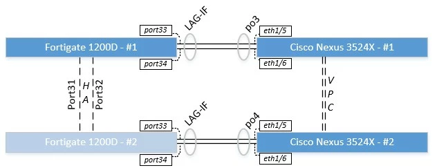

Hi,
I am trying to setup a LAG between a Fortigate 1200D cluster and a two Cisco Nexus switches.
But I do not get the aggregation online.
Our setup looks as following:
I know this setup is a little bit uncommon because normally you would connect the fortigates to both switches but because of limitations of the Nexus switch this is not possible.
The Nexus switches are both configured with there own portchannel (po3 and po4).  The portchannel on the second switch (only connected to the passive firewall) is as expected not up. But the port channel on the first switch (connected to the active firewall) doesn't come online either.

Hi. Looks like Fortiswitch has LACP "active" and in Nexus it is "passive". Try change Nexus ports to "channel group .. mode on".  Why do you use two port-channels between the switches? With this setup one of the connection will be STP blocked (on VLAN). If you use mc-lag / vpc all interfaces will be in same port-channel and you will have double capacity in between and no STP issues./C
BitCube1
BitCube1Author
January 3, 2022
We have two port-channels because it was not possible to do layer3 over VPC. Between the Fortigates and the switches we use BGP.
Today I looked together with a Fortinet engineer. Both devices (Nexus and the Fortigate) have a high TX but RX is 0. It looks like the used (Twinax) DAC-cables our the problem here. Once we replaced the cables we will know for sure.
/ Richard
