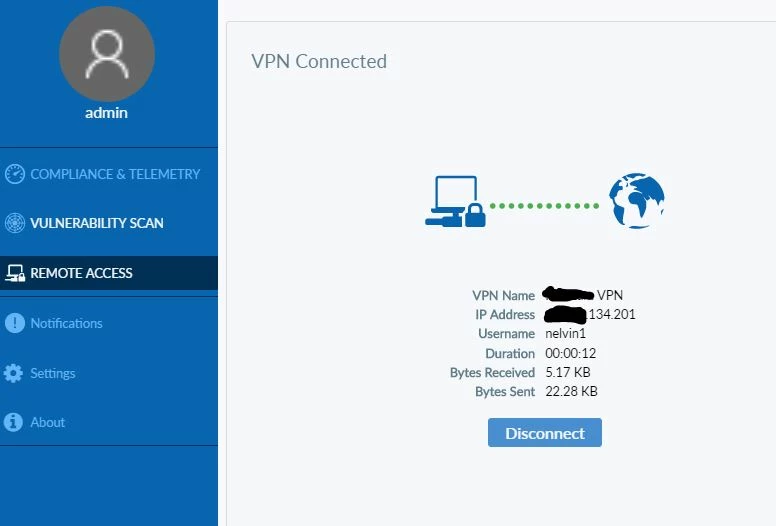

Hi everyone,
I connected forticlient-SSLVPN and get the connection.
But the problem is I unable access to my internal server.
Configuration for Fortigate 100E as attached :
Should I add remote groups for the internal server?
Does anyone got solutions for me to try? thanks in advance =)

    Is it "split-tunnel" or "no split". If split, check your PC's routing table w/ "route print" to see if server IP/subnet is there. The destinations have nothing to do with remote groups. It's decided by 1) routing (in case split) and 2) policy for ssl.root->internal interface.

    Hi Toshi Esumi,
    Thanks for your suggestion.
    I didn't enable the split-tunnel function.
    And I checked and opened all the services in IPv4 policy, ssl.root --> Internal LAN.
    Finally, I found out the issue.
    My company network IP range is 192.168.1.X, internal server 192.168.1.254.
    Branch site router IP range also 192.168.1.X.
    Both network conflicted.
