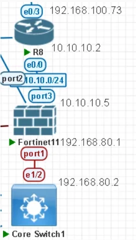

i have a problem in my network , i cant ping ping from outside (port3) to inside (port1) and vice versa although I have configured all the settings correctly I think. ip addresses and policies and static routing
and that is the static routing and policeis configuration

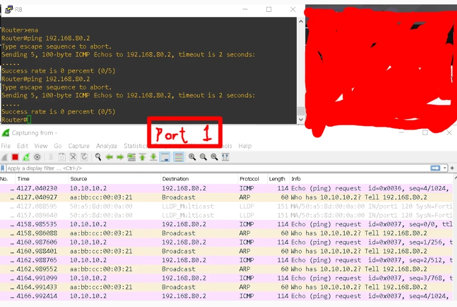

i tried to ping from core switch to router and i caprute the packets by wireshark in port1 and port3 , the core switch send arp request , but the firewall dosent forward the arp request and it dosent send arp responce also , but when i try to ping from router to core switch , the router send ICMP and the firewall forward it but the core switch send arp request again and the firewall dosent respone for the arp requset also . someone tell to use proxy arp and i try but it dosent work then i remove the prxoy arp , i dont know if i write the configuration corecctly , but i dont think so it will work even i write it coreectly
