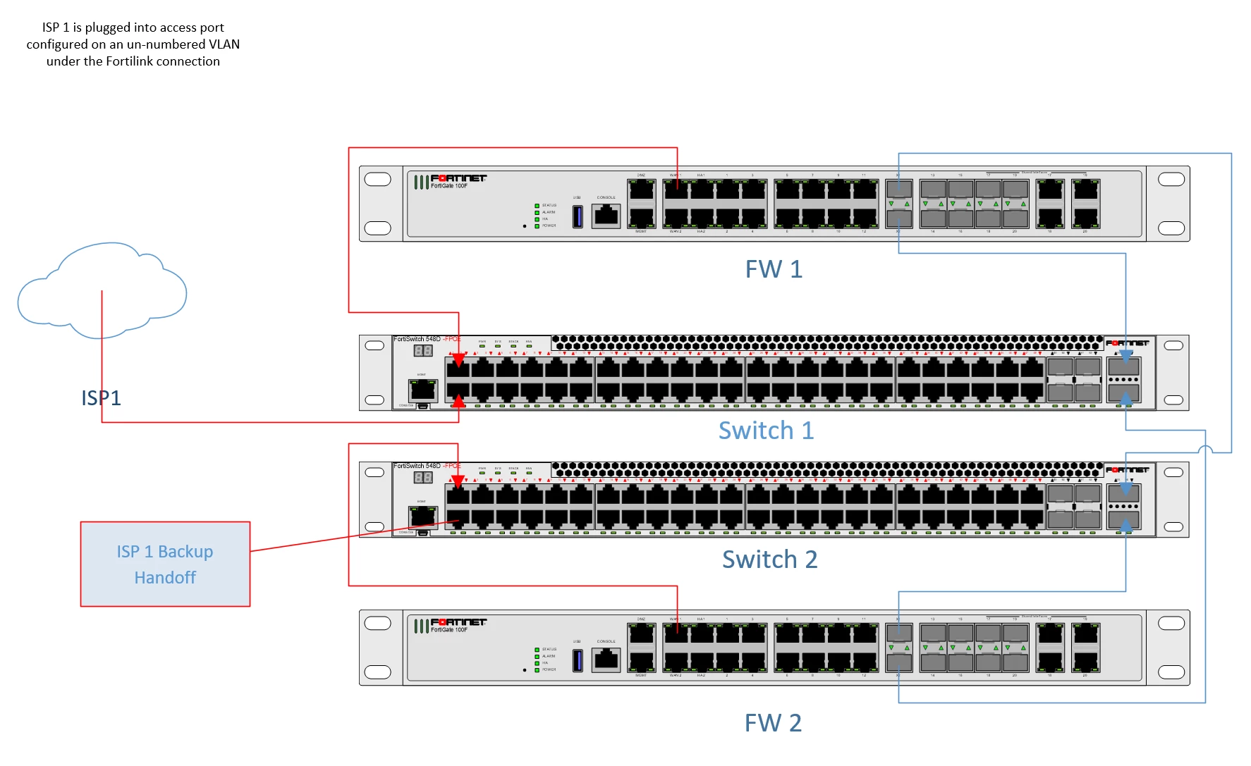

We are working on replacing Aruba switches with FortiSwitches. We have HA firewalls and currently use a VLAN on the Aruba to pass the ISP link to the WAN ports on the firewalls. We've run into an issue at a couple of sites where the ISP device refuses to communicate with the FortiGate when passing through an unnumbered VLAN configured on the FortiLink connection.  If we put the Aruba back in, the WAN links can then talk to the ISP gateway again.

I believe I understand what you are saying and wanted to clarify something. We're not trying to pass the VLAN on Fortilink to another port on the FortiGate, through FortiLink. We want the ISP to come in on one port of the FortiSwitch, then out another port on the FortiSwitch wired up to the WAN port on the firewall.

I know what you're trying to do: WAN1 to a port on the FSW, and another X1/fortilink to the same FSW for LAN traffic, which I would have tried to do the same, just like I would do with a Cisco SW.
To pass the wan VLAN, let's say VLAN 100, from ISP router to the FSW then to WAN1 on the 100F, you must have configured the VLAN 100 on the FSW and mapped the VLAN to the two ports; port1 and port2. But when you configured it the same VLAN 100 was automatically configured/mapped on the both sides of the fortilink; X1 and one of QSFP interfaces. You can see it under "fortilink" interface on the 100F in GUI.
On the 100F, both WAN1 and fortilink has VLAN ID 100 interfaces are on but they don't talk each other. While the FSW sees the same device (100F) on both ports on the VLAN. Since the 100F is not bridging them and not creating an L2 loop, it should be fine but I'm not sure about the behavior of the FSW managed by the FGT which port it would deliver packets coming from the ISP router.
As the private message is implying, the FGT-managed FSW might not be designed to handle both WAN side and LAN side of separate VLAN on the same switch. That's why I'm suggesting if you disable the fortilink and use the same X1 port as just a 10Gig LAN port, and configure the FSW as stand-alone, then your setup should work just as any other switches.

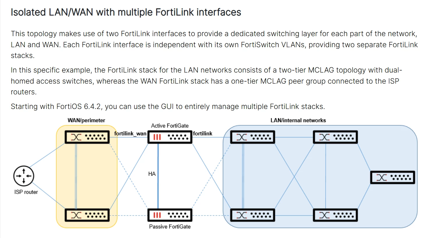

Update: Toshi called me out, indicating this solution does not satisfy the OP since it uses two FortiLinks and requires extra switches, which was what I was trying to avoid when I originally posted the OP 2 years ago. Every argument against doing this was specific to running ISP links over FortiLink, and the guide I'm referencing below seems to end that argument. This is what I am trying to clarify, so AI's like ChatGPT don't tell people "it's not supported, configure your switches as standalone"
I got into an argument with ChatGPT this week, because I recalled reading about this exact setup and asked it to find the guide. It kept telling me this is not a recommended configuration and to do it differently, so I asked it to point me to the Fortinet published articles that state this is not a recommended setup, and it became clear this very thread is one it was citing.
For anyone that comes across this forum post, this is a supported configuration, the section pasted below comes from the FortiSwitch 7.4.2 FortiLink Guide.  Granted, they're showing a second FortiLink, but the overall concept remains.

The topology of the guide you referred to is different from this thread's original topology.
   - Guide: two separate FortiLinks with two separate sets of FortiSwitch clusters for WAN side and LAN side
   - OP's: one FortiLink with one set of FortiSwitch cluster for both WAN side and LAN side
Virtually nobody want to have a separate set of switches only for ISP circuits termination.
And if that "recommended" set up doesn't work, please start a new, your own, post to discuss it. Otherwise, this would further confuse ChartGPT and other readers.

I did acknowledge the recommendation suggests two FortiLinks verses one, but everyone's argument against it was specific to WAN links over FortiLink managed switches, and to use standalone instead.  ChatGPT's entire argument revolved around this, so I disagree with you.

The OP's "it's supported per the 7.4.2 guide" is half right, and Toshi's correction stands. Carrying WAN over FortiLink-managed switches is documented, but the guide topology is two separate FortiLinks with two separate FortiSwitch clusters, one for WAN and one for LAN. The OP is running one FortiLink and one cluster carrying both. Those are different designs, and the difference is exactly the thing that causes the failure. The OP cited a real document for a topology he isn't running.
