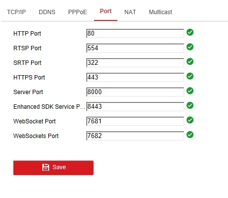

Very simple vpn set up for my iPhone. I have a Fortigate 40F firewall. I'm able to access my movie server after successfully connecting to the vpn but not the hikvision cameras that I have configured on the Hik-Connect app. I can reach https://x.x.x.x:443 (camera1) on my iPhone using Safari while connected to the vpn. so that port is working.
The live feed fails once it hits 80%. "device connection timed out" Please check its network connection. But I can reach my movie server and access the web sign in of the camera using https. Help? Cameras work flawlessly when on the local network through wifi.

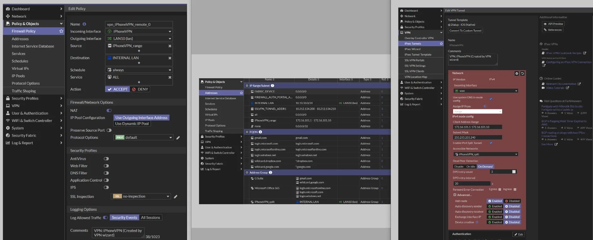

VPN is allowed to access my entire lan and "all" services (ports)

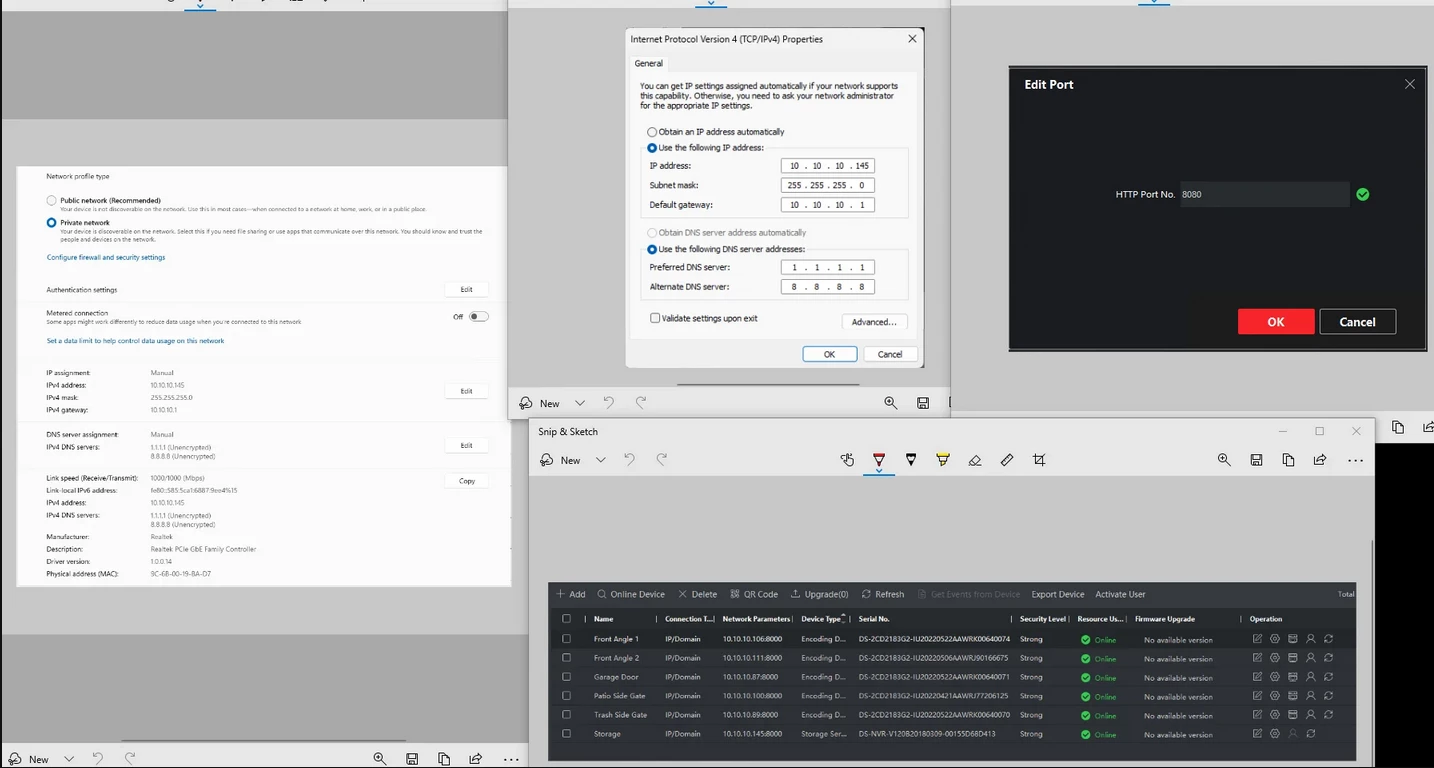

Modem > Fortinet > Ubiquiti 24 Port PoE > connects all my ethernet, three aps and 5 cameras. All on 10.10.10.0/24. Flat network nothing else. NVR is a Windows 11 Pro Host running iVMS-4200. No VLANs, nothing. Flatter than Earth.
Log Allowed Traffic is set to "All Sessions"

  1. NAT Considerations: Since NAT is enabled in the policy, but the internal network (10.10.10.0/24) is already managed behind the firewall with the firewall as the default gateway, NAT may not be necessary. Using NAT in this scenario could lead to application errors due to TCP connection limits when multiple sessions share a single IP. Disabling NAT could help eliminate these issues and improve connectivity stability.

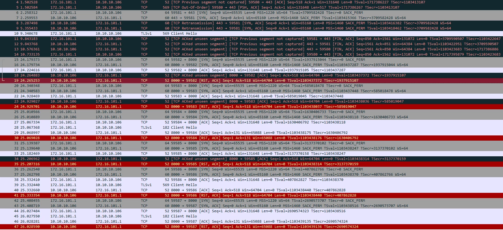

2. I didn't touch the session timeout value and proceeded to capture packets when accessing Camera1 via https://x.x.x.x:443https://x.x.x.x:8000 (iPhone - Safari.) Packets were captured here BUT when I try and click on Camera1 within Hik-Connect no packets are captured. Simply nothing happens.

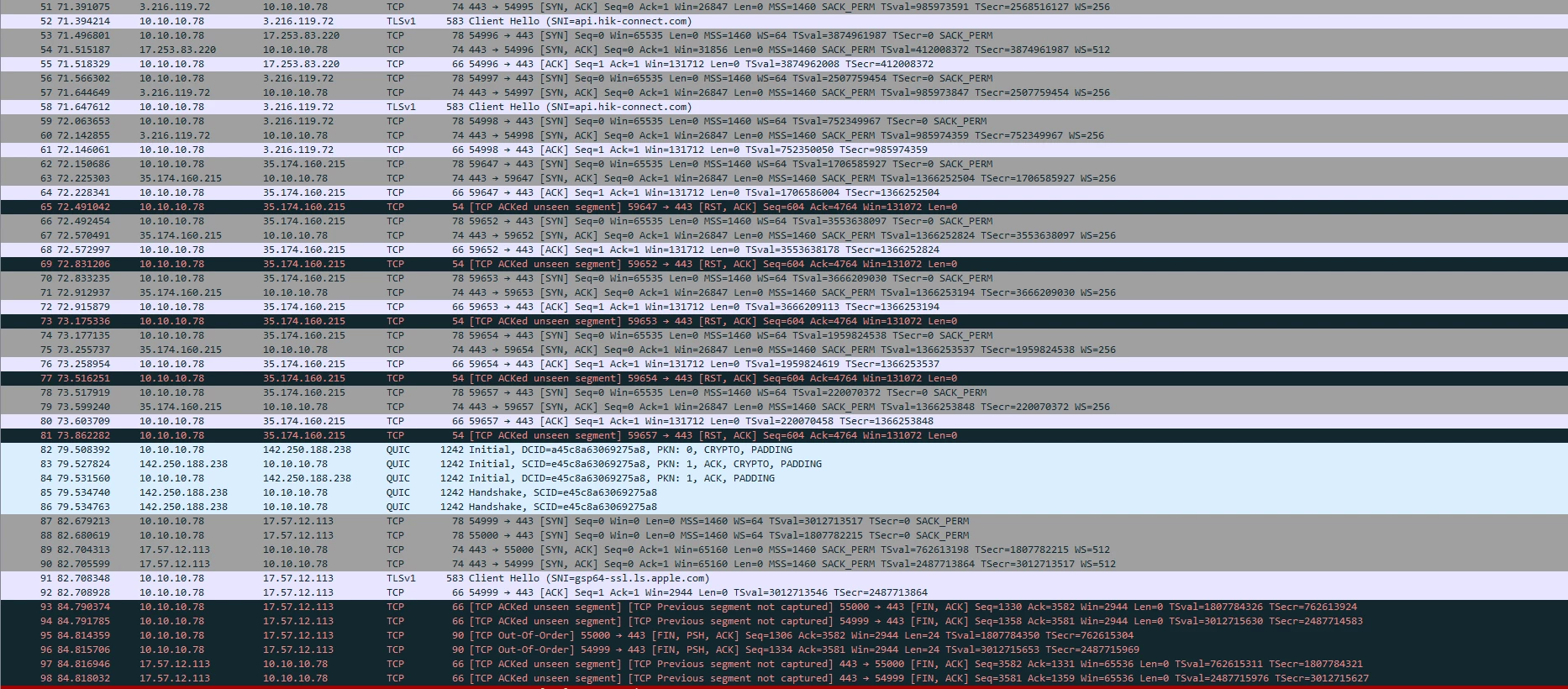

This is what happens when I connect to my WiFi and click on Camera1 within Hik-Connect. There are packets captured. I launched the app, packets. I refreshed all 5 cameras, packets captured.

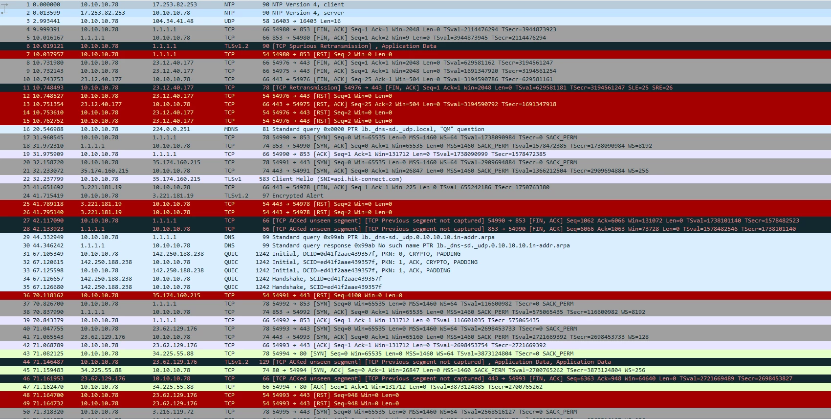

On VPN, nothing (within the app) & to confirm, captured packets when using the Safari app.
