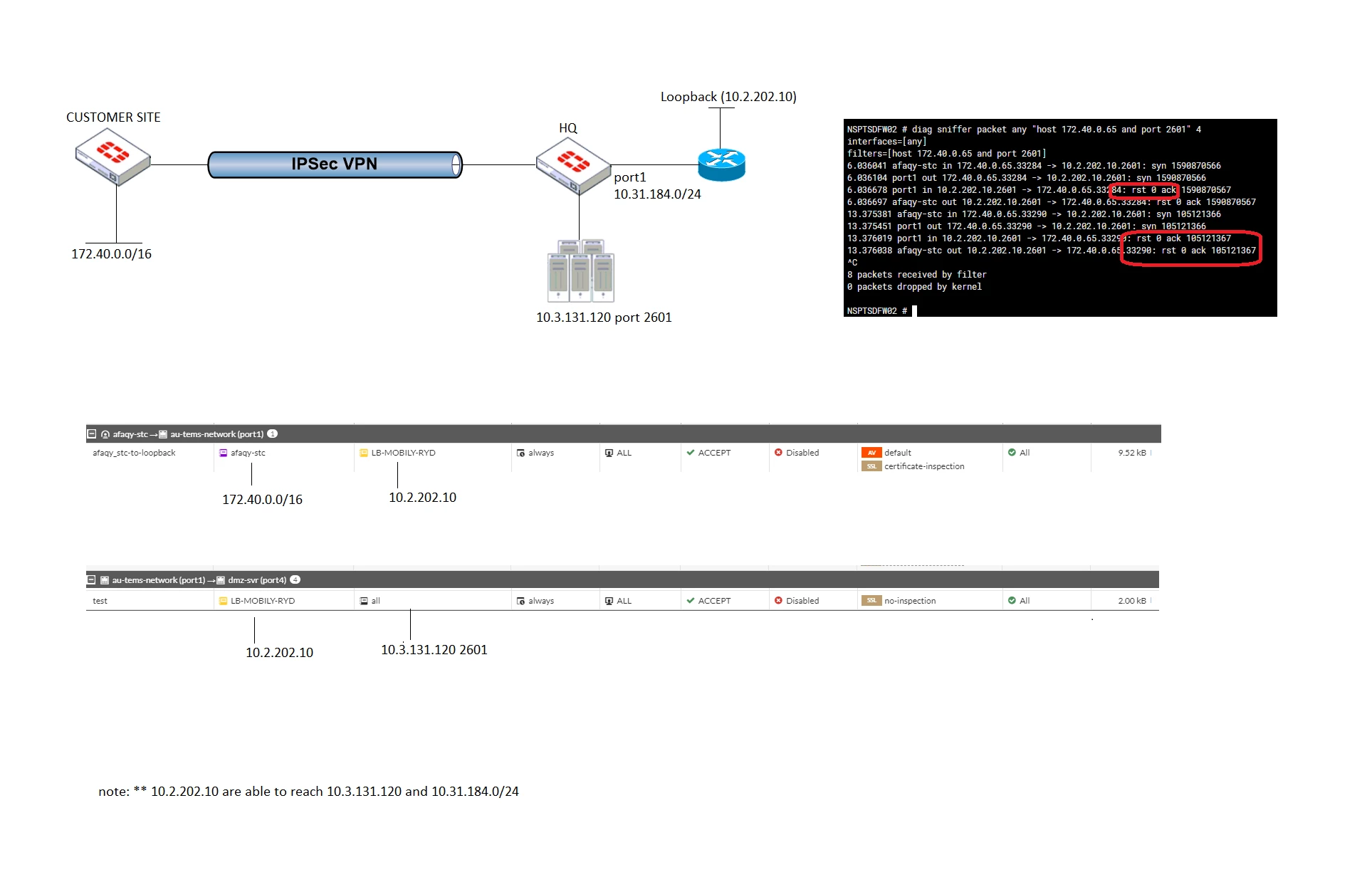

Gentleman,
I need support, show below that port 2601 on server that is map on loopback 10.2.202.10 is getting reset, but going direct to server port is open.
Need some help why going to loopback is resetting.

Hello @hbuenafe81 ,
Can you run these diagnose commands and share the output with us? While running these commands you need to try to access 10.2.202.10:2601
diagnose debug disable diagnose debug flow trace stop diagnose debug flow filter clear diagnose debug reset diagnose debug flow filter dport 2601 diagnose debug flow trace start 100 diagnose debug enable
Also are you sure about, your TCP/2601 service status listening on the server? Can you try this with that command?
execute telnet 10.3.131.120 2601

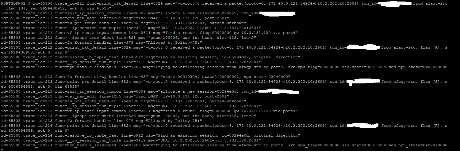

Gents,
need help port suddenly stop working. Below debug for your informations.

Hello @hbuenafe81 ,
Do you have a VIP configuration related to 10.3.131.120:2601?
If you say yes, can you enter this command in that VIP configuration?
config firewall vip edit "YOUR_VIP_NAME" set arp-reply disable end
If you don't use this VIP you can also delete it.

Hi ozkanaltas,
I have multiple entry for on VIP for this 10.3.131.120. although it was working earlier and suddenly stop.. any idea you got base on log provided?
