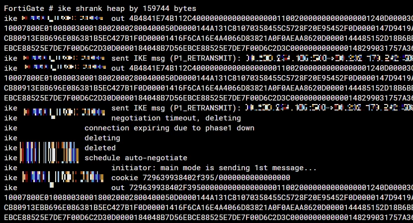

After upgrading our FortiGate to v7.4.0 from 6.4.7 (with optional upgrade path 6.4.9 then 6.4.11 ...)
All our IPSEC tunnels are down and phase1 and phase2 are down. At the same time all other config seems to be in place...
We found out that as soon as we choose local gateway "Specify" (our secondary WAN IP) not "Primary IP" the tunnel is down and no communication is happening between our and client FW (all WAN IPs are from one ISPs GW). We can ping clients IP.
Proposals and configuration of P1 and P2 are correct, as I mentioned as soon both sides chooses gateway (our primary IP) tunnel works. Policies are in place, traffic is accesable from both sides when tunnel is up. Routes created.
What could be the possible issues where to look. I tried to find similar issues on forums but no success. Would appreciate any ideas and help.

As per the debug there is no response from peer, since the configuration was working previously it could be related to route.
Can you share below output.
get router info routing-table details x.x.x.x ->peer ip
get router info kernel | grep x.x.x.x

Can you collect sniffer
diagnose sniffer packet any "host x.x.x.x" 4 100

wan1 in x.x.x.x -> x.x.x.x: udp 292
wan1 out x.x.x.x.500 -> x.x.x.x: udp 292
wan1 out x.x.x.x -> x.x.x.x: icmp: host x.x.x.x unreachable
wan1 out (PrimaryIP) -> (PeerIP): icmp: host (SpecifiedIP) uncreachable
Specified IP is the one we want to use in our ipsec configuration
there is som 500 packets becouse it tries to establish IPsec tunnel.
what is interestings the ICMP timeouts
