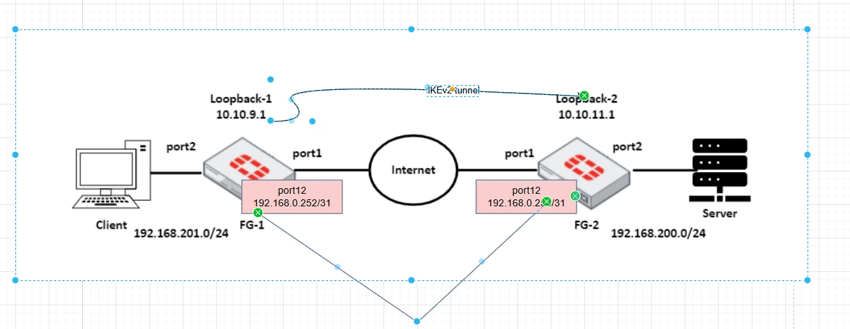

I have created a IKEv2 sit to site tunnel between fortigates using loopback addresses on Port 1. I also have a 10Gbps point to point link between two sites on port12 which is used a primary connection. I want to use Ipsec tunnel as a backup connection so that if point to point link is failed all ip traffic is switched over IPSec tunnel.
Following is my config. Can some one suggest a solution for this scenario.

Hi There,
Since you consider using a P2P link as primary, tweak the AD in case of static route or other route manipulations for OSPF/BGP and config link monitoring. Refer to the link https://docs.fortinet.com/document/fortigate/6.2.16/cookbook/723056/link-monitoring-and-failover
