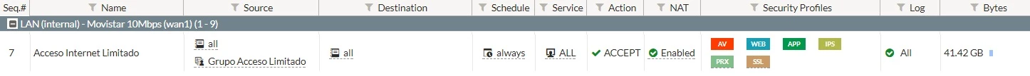

Hi guys,
I wonder if enabling IPS in the direction LAN --> WAN is necessary or not in order to protect my PCs againts attacks. I mean enabling IPS from LAN to Internet, like this:
Is it ok?
Regards,
Julián
    Best answer by tanr
    The short answer is yes.  Enabling IPS on the outbound policy should protect the sessions that are initiated by that policy.  in general you should not have a wan --> lan policy.
    fjulianom
    fjulianomAuthor
    Explorer II
    December 4, 2017
    Hi tanr,
    Ok, thank you. I also have enabled IPS in a WAN --> LAN policy in order to protect the customer servers, because the customer is using Virtual IPs and Destination NAT to access some servers remotely. I just wanted to be sure because some collegues told me that I only needed enable the IPS in the WAN --> LAN direction and not in the LAN --> WAN direction. Then I wondered, how will I protect the hosts againts attacks initiated from outside? And as you told, enabling IPS on the outbound policy should protect the sessions that are initiated by that policy (therefore by the hosts).
    Many thanks!
    Julián
    tanr
    December 5, 2017
    Correct.  As long as your wan --> lan policy is just for the VIPs and has its own protection profiles that should be fine.
    BTW, if as part of your WAN --> LAN rules you have a DENY policy that involves VIPs, you should check that it has match-vip enable.  Otherwise it is possible that those rules won't be matched.  http://socpuppet.blogspot.com/2016/02/this-is-reminder-for-set-match-vip.html
    Que le vaya bien.
