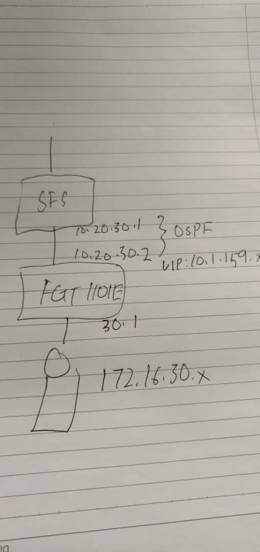

Hi,
Referring to the diagram attached, FGT is connected to the upstream server farm switch with OSPF (10.20.30.2).
The interface configuration is as below:
WAN: 10.20.30.2 (OSPF interface)
LAN: 172.16.30.1
We would like to configure VIP at the internal FortiGate with IP segment 10.1.159.0/24 at the WAN interface and mapped it to the internal server.
We had tested the VIP at our labs and it is working as intended.
However, we are having some suspicious about whether the server can go to the internet or not with this configuration.

The objective is to allow the internal server to go to the internet with NATting to 10.1.159.254 or any other IP Pools within the 10.1.159.254 segment. Please advise if it is doable.

AlexC-FTNT
February 1, 2022
As long as there is a route to the internet for the 10.1.159.x, it should be possible.
OSPF may only give you the default static route (with the next hop being in 10.20.30.x).
But you can still add a static route with lower metric for this server for the 10.1.159.x IP range.
Debbie_FTNT
February 1, 2022
Hey umar,
with the policy Pool2ndIP as outlined, the host 'servertest' would be allowed to access whatever can be reached through LACP-WAN interface, and traffic from servertest would go out the LACP-WAN interface using IP 10.1.159.25
If your routing is in order as Alex mentioned, I would not expect any issues.
