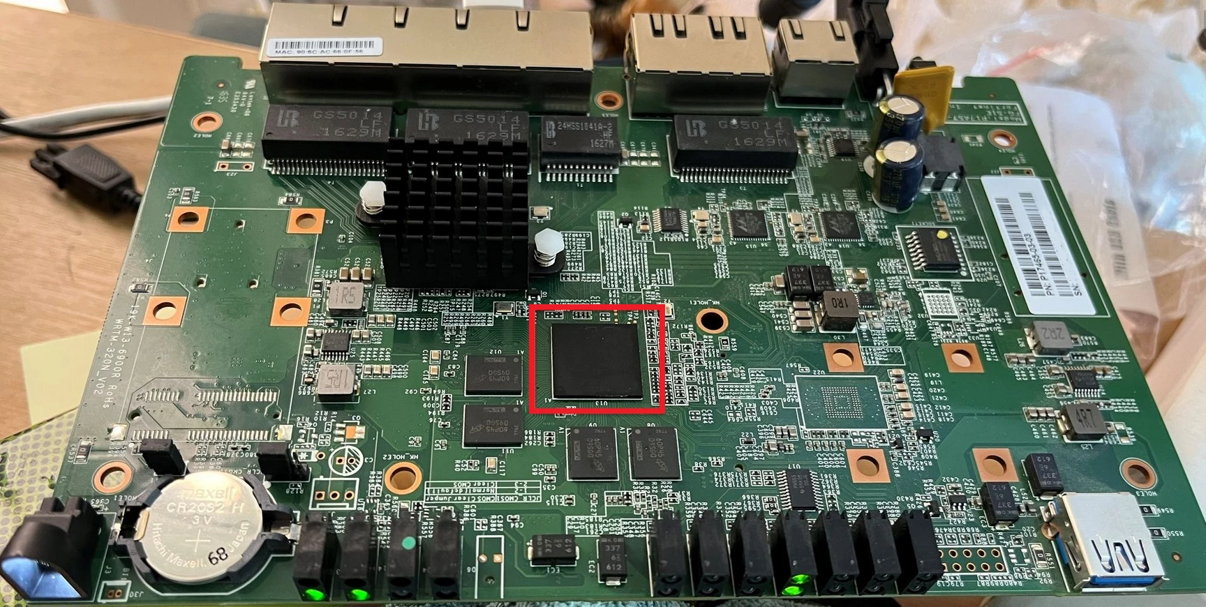

SupportSTR
September 10, 2024
You can repair it, just heat the CPU with a hot air gun which will resolder the solders under the CPU. The problem comes from the ball solders under the CPU which degrade over time, you just have to melt them for a few seconds for the FG50E LAN ports to work again :
FG50E CPUFG50E CPU
See more here : https://community.fortinet.com/t5/Support-Forum/Fortigate-50E-Dying-Packet-loss-and-lan-ports-stop-forwarding/td-p/202451/page/3
