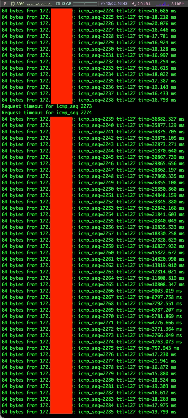

    Might be unrelated, but I’ve noticed something similar with our split tunnel FortiClient SSL VPN. Have two continuous pings going - one to 1.1.1.1 and the other to a device across the VPN. intermittently / Transiently, I’ll see the pings to cloudflare continuing on like normal, but while that’s happening (ruling out a poor home network connection), the pings to our on-prem host will just freeze - and then I’ll get responses about 10 to 15, sometimes 30, seconds later.
    We just signed up for FortiClient Cloud EMS, so I’m using the new client (7.4.8.1977 - Mature) and are terminating onto our FortiGate on 7.4.12. I didn’t notice this issue at first, but it’s much more noticeable lately. VPN connection doesn’t drop, just massive amount of lag:
