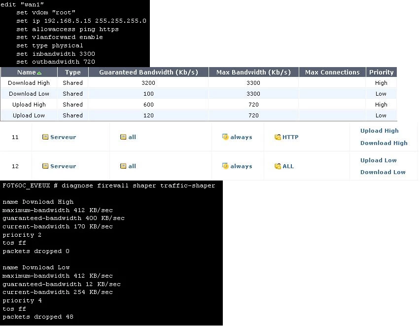

Hello,
i have a 4m/0.9m adsl connection and want to prioritize inbound traffic. So to test that, i'm using an example with http and ftp. When i'm downloading from ftp at full speed, http must be higher priority to not suffer from ftp inbound. In a very simple steps, i have created 4 shapers :
"Down Low" : FTP 0.1Mb guaranted and 3.9Mb max Low prio
"Down High" : HTTP 3.8Mb guaranted and 3.9Mb max High prio
"Up Low" : FTP 0.1Mb / 0.7Mb Low
"Up High" : HTTP 0.6Mb / 0.7Mb High
Wan1 interface set inbound 3900Kb/outbound 700Kb
2 policies: internal -> wan1, FTP shaper "Up Low"/ Reverse "Down Low". HTTP shaper "Up High" / "Down High"
Upload is working very well, when FTP is at 0.7Mb, sending http will drop FTP to 0.1Mb. But downloading is not working. I have tested all the possibilites of guaranted traffic, DSCP, TOS, using same shaper with low priority, application control, nothing. FTP and HTTP downloading is approx the same rate 50% of inbound. I have also tested with no max and with no guaranted, not better. I can limit max bandwitdh to ftp, it's working but it is not i'm searching, i want FTP downloading to use max when other traffic is idle and being low when http traffic is used.
I have used too many times on this problem and support have no solution. So is the fortigate is really capable of limiting inbound traffic like i want ?
Thanks :o)

chreggy
chreggyAuthor
August 20, 2015
Policies are matched and this problem is still the same on 4.3 and 5.0. FTP download is using "Download Low" and HTTP download "Download High". Logically, le fgt must drop FTP packets to guaranty HTTP 400KB/sec but not. The same schema is working perfectly with HTTP "Upload High"and FTP "Upload Low".

chreggy
chreggyAuthor
September 3, 2015
I know this is not a normal working set i want. But in pfsense for example, it's working very well with one method, shaping LAN outbound. The fortigate cannot do that because we must configure it in reverse shaping of the wan rule. Another example is Tomato firmware or dd-wrt/openwrt, it's working very well on inbound traffic. So i think FG cannot do that after many tests.

chreggy
chreggyAuthor
September 3, 2015
I have posted a screenshot on my second response. I'm an advanced fortigate user and like you said, TS is not logical on inbound traffic, only outbound. My example is about FTP/HTTP. So the config is simple, 1 TS for outbound High, 1 for outbound Low, 1 for Inbound High and 1 for inbound Low. Two policies, 1 for HTTP and 1 for others with the shapers. I see that the inbound is using the right shapers but no priorities is applied. I'm searching the solution.

chreggy
chreggyAuthor
September 3, 2015
I have applied 12KB/412KB for inbound low and 400KB/412KB for inbound High, it's not the right method ? In a perfect world, FTP should down to 12KB/s while HTTP 400KB/s, no ?

chreggy
chreggyAuthor
September 3, 2015
it's kb/s in the GUI and KB/s into the CLI
