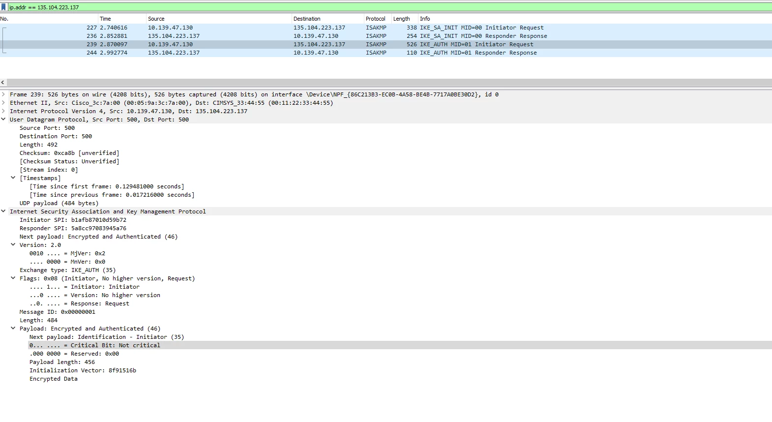

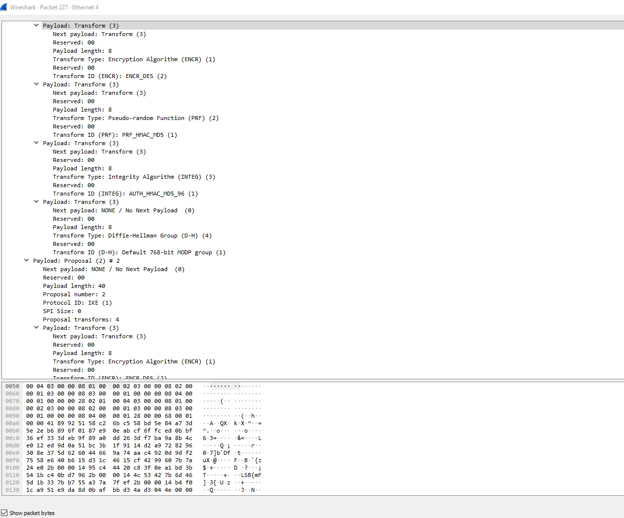

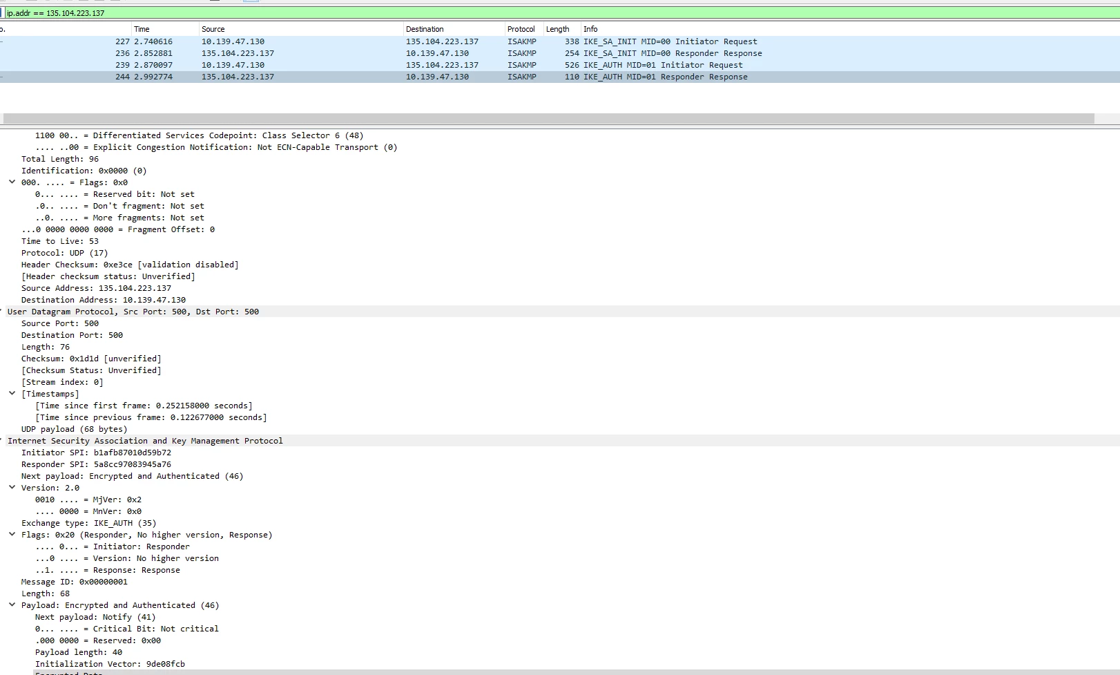

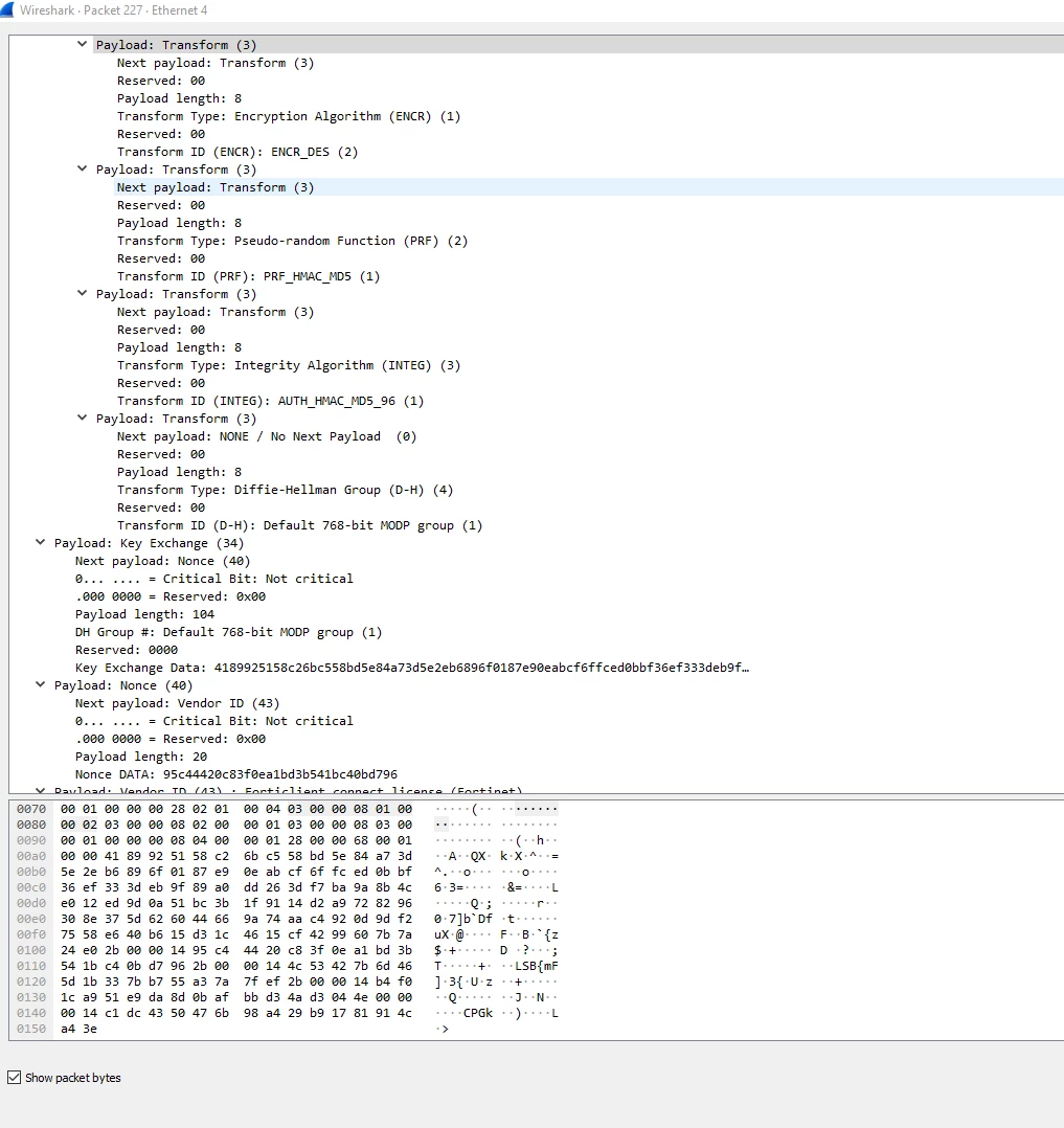

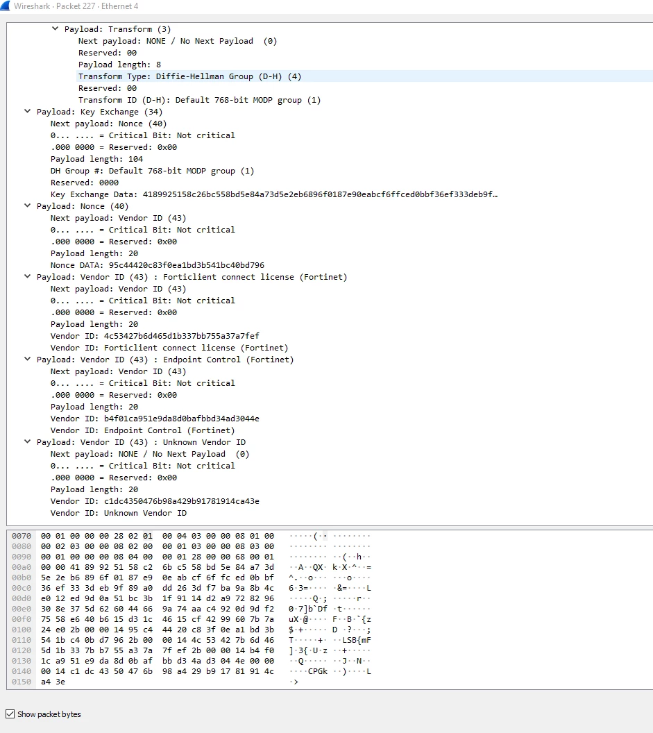

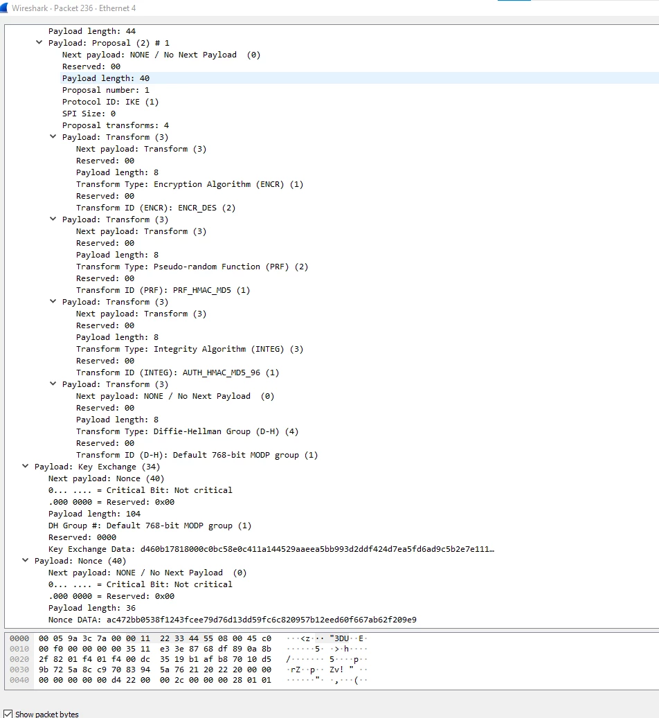

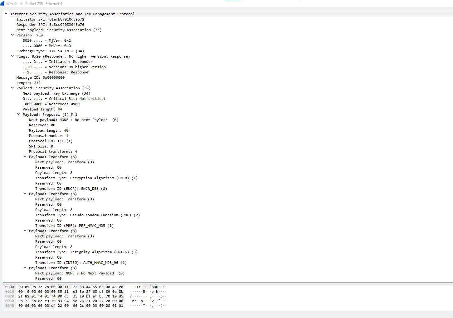

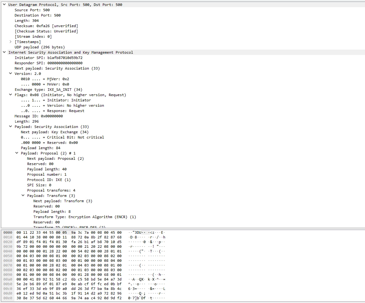

Hi All,
I am new to this forum, I am trying to setup VPN connection between Nokia 7750 SR router to FortiClient VPN,
below are the config settings.
Please note:- This issue happen only Option DHCP is selected, the VPN tunnel comes up correctly when manual IP is selected.
Forti VPN Client:-
Authentication Method:- Preshared Key
EAP is disabled
IKE version - 2
Options :- DHCP
PHASE-1
Encryption:-  DES Authentication :- DES
DH Group:- 1
key Life:- 86400
No Local ID
No DPD
No NAT
No Enable Local LAN
Phase2 :-
Key Life:- 43200
No Relay Detection
No PFS
7750 Router is config as IKEv2 with all the config matching to FortiClient VPN. For DHCP option router is dumping below messages.
failed because ipsec-gw has local-address-assignment configuration but IKE_AUTH did not contain a config payload."
Please find the attached screen shot of all the four packets attached,
It will be really help if you some one can find the root cause.Packet 1.1.pngPacket 1.2.pngPacket 1.3.pngPacket 1.4.pngpacket 2.1.pngpacket 2.2.pngPacket 3.pngpacket 4.png
