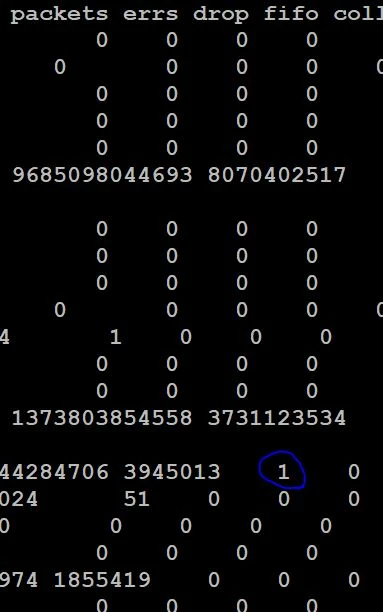

Hi, I'm engineer from Korea
When I was check Client system I found interfaces error
But I don't know cause
Could I get Help?
Device - Fortigate-80E
Firmware - v6.2.8

0.0001% errors can be safely ignored

If that '1' is the third number in the line after the interface name in "diag netlink device list", it's the number of errors on receiving side. It could happen for many reasons, like when you unplug and replug it in. So most important thing is if the number increases. Just keep running the command repeatedly to see if it changes.
If stays as '1', I would call it good.
