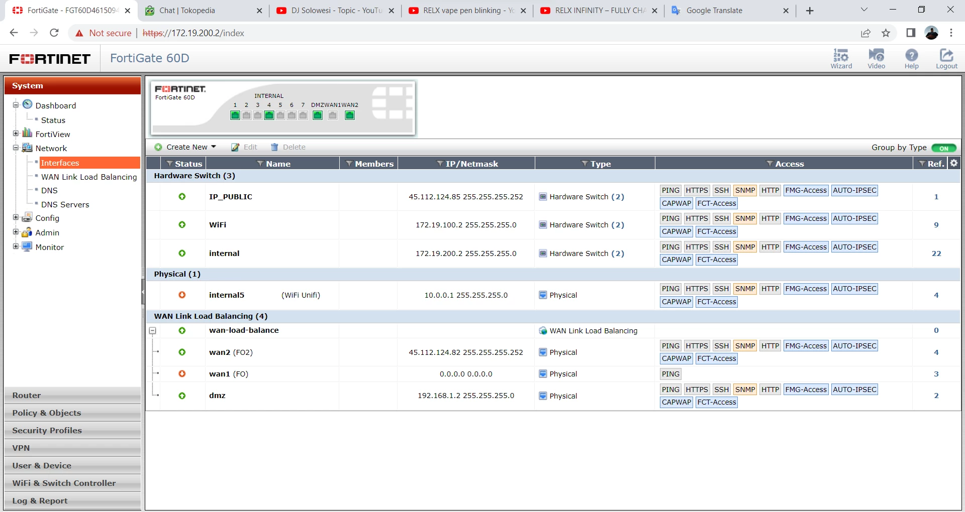

i just a newbie in fortigate,
We have two interface in my FortiGate 60D
LAN 172.19.200.2/24
Wifi 10.0.0.1/24
we Can Akses the device only with the ip address., example LAN to Wifi, Wifi to LAN using ping the ip address..
but when Wifi akses to LAN using Device Name (computer name, printer name) coming the error, the network Access is not accessible. and file sharing can not access too.
can anybody help me to solved it? Thanks,

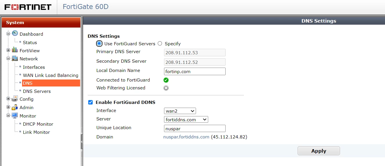

Hi Sir,
I had change the Network - DNS..
primary DNS 27.123.220.220 (ISP DNS)
Secondary DNS 8.8.8.8
the problem still exist., I can not ping by Device name for Different Network (ex: 172.19.200.12 to 10.0.0.24), just can ping by ip address..

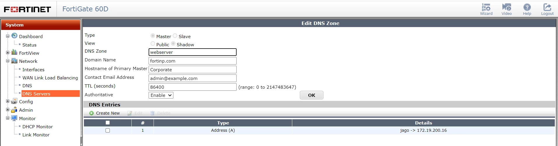

i can make DNS Server database work..
even i create the internal DNS Server, when i ping never connect. why?
I try my best to follow the instruction from https://docs.fortinet.com/ and from the YT video..
what the mistake??

did you create a DNS database on FortiGate to allow resolution of the hostname?
If yes, can you share that config with us?
Once you have that set up, you would have to ensure that your clients are actually using that FortiGate DNS database, and not google or ISP or any other public DNS.
Those public DNS likely will not be able to resolve your internal workstations.

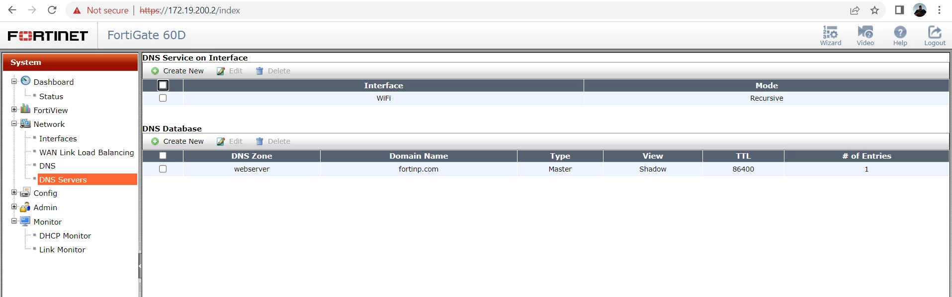

there is a Capture what we Configured to our Fortinet

Hey Dhanz,
that looks ok to me.
Devices connected to the Wi-Fi interface (as long as they are using FortiGate interface IP as DNS) should be able to resolve the hostname 'jago'.
Are devices connected on the Wi-Fi interface using FortiGate interface IP as DNS?
On Windows, you can check this with "ipconfig /all" in CMD.

This is My Interface., and I Just want that Inteface Wife and Internal Can Connect each other with \\,Device Name>

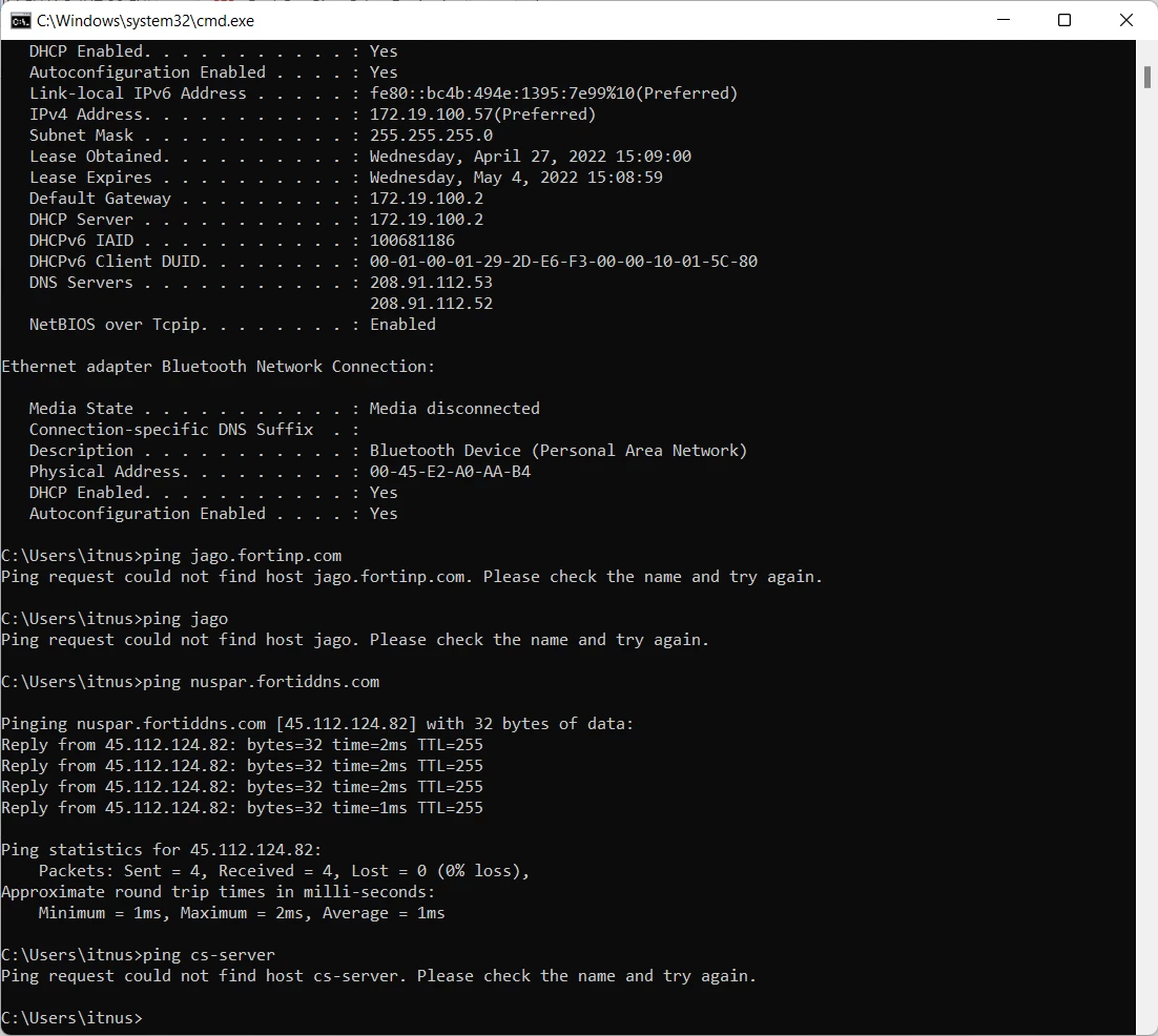

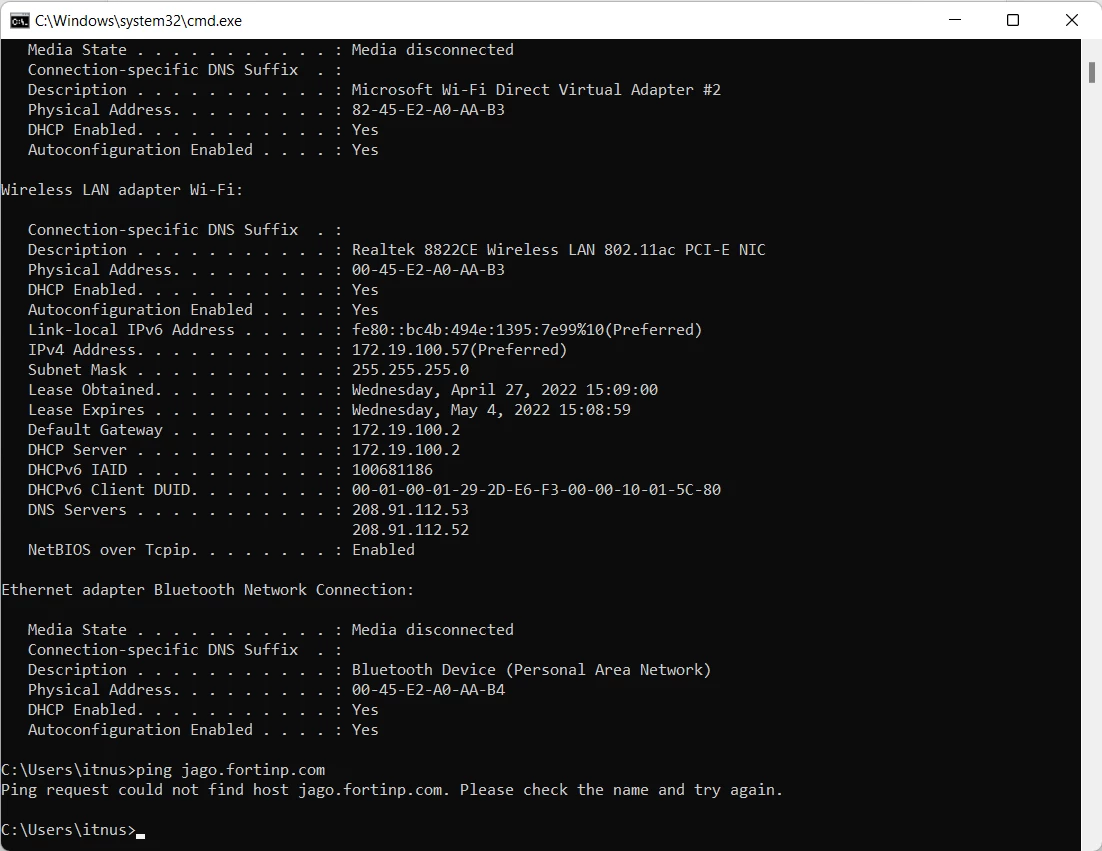

The Result of CMD
ipconfig /all
ping to fortigate ddns (Success)
Ping to Local Domain (Not find Host)
still can not Ping Wifi to LAN via Device name

ipconfig /all  DNS using Fortigate,
but can not access to jago.fortinp.com, why??
