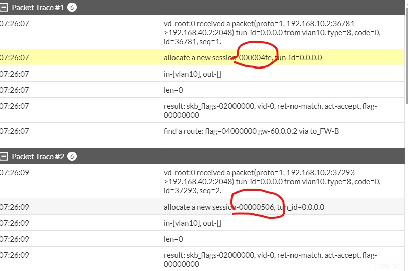

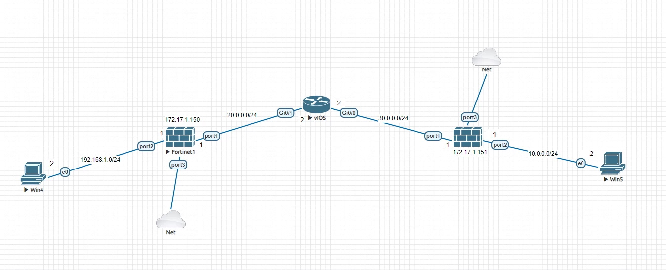

I have established a site-to-site (S2S) tunnel with two FortiGate firewalls, and this is my topology.
then the tunnel work but no perfectly it can ping juste from the interface of the lan to the other lan interface (and vise verca) (exmple : ping from 192.168.1.1 to 10.0.0.1 it works but if we want to ping from the to the other host the ping issue )

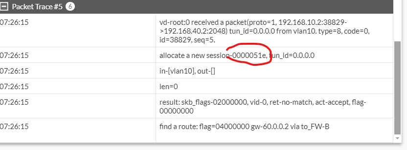

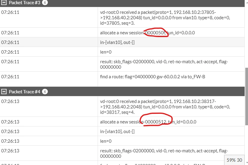

after some time of troubleshooting i find out that the icmp session losed in evry icmp request
so guys  what is the solution for this problem please !

bpozdena_FTNT
February 27, 2024
A new session is allocated for each ICMP type 8 message because they all have different identifier.
To fix this issue, change your Ping application or its settings to ensure the ID remains the same . Fortigate will then consider them to be part of the same ICMP session.

Hi @khalilbouzaiene1 ,
Based on this statement:
Can you tell me the finding that you had?
Example:
ping 192.168.1.1 to 10.0.0.1 - working
ping 192.168.1.1 to 10.0.0.30 - NOT working
Im afraid this something related to phase2.
Please let me know the output.
ping 192.168.1.10 to 10.0.0.1 - working
ping 192.168.1.10 to 10.0.0.30 - NOT working

hello my friend
in our case when i try to ping from the lan interface 192.168.1.1 to 10.0.0.1 (these adresses are the interfaces of the lan that are related to fortigate directly (look to the tpology)) i have this result
FW-A # execute ping-options source 192.168.1.1
FW-A # execute ping 10.0.0.1
PING 10.0.0.1 (10.0.0.1): 56 data bytes
64 bytes from 10.0.0.1: icmp_seq=0 ttl=255 time=3.0 ms
64 bytes from 10.0.0.1: icmp_seq=1 ttl=255 time=1.0 ms
64 bytes from 10.0.0.1: icmp_seq=2 ttl=255 time=1.4 ms
64 bytes from 10.0.0.1: icmp_seq=3 ttl=255 time=1.2 ms
64 bytes from 10.0.0.1: icmp_seq=4 ttl=255 time=1.2 ms
--- 10.0.0.1 ping statistics ---
5 packets transmitted, 5 packets received, 0% packet loss
round-trip min/avg/max = 1.0/1.5/3.0 ms
and now when i try to ping from 192.168.1.1 to the host on the lan (10.0.0.2) not the interface
FW-A # execute ping 10.0.0.2
PING 10.0.0.2 (10.0.0.2): 56 data bytes
--- 10.0.0.2 ping statistics ---
5 packets transmitted, 0 packets received, 100% packet loss
and vise versa if we wenna try the same from the other lan interface we will have the same
do you thing that this is related to phase ??
Contributor III
February 27, 2024
Thank you for the respond.
Looks like anything behind the fortigate peer is not reachable.
Please test this scenario:
On Fortigate2(peer side), please ping 10.0.0.2.
We need to make sure this Fortigate2 itself able to reach 10.0.0.2.
Else, you need to fix on the Fortigate2 1st. Maybe you have routing issue.
Or 10.0.0.2 did not allow ping. You may disable windows firewall.
