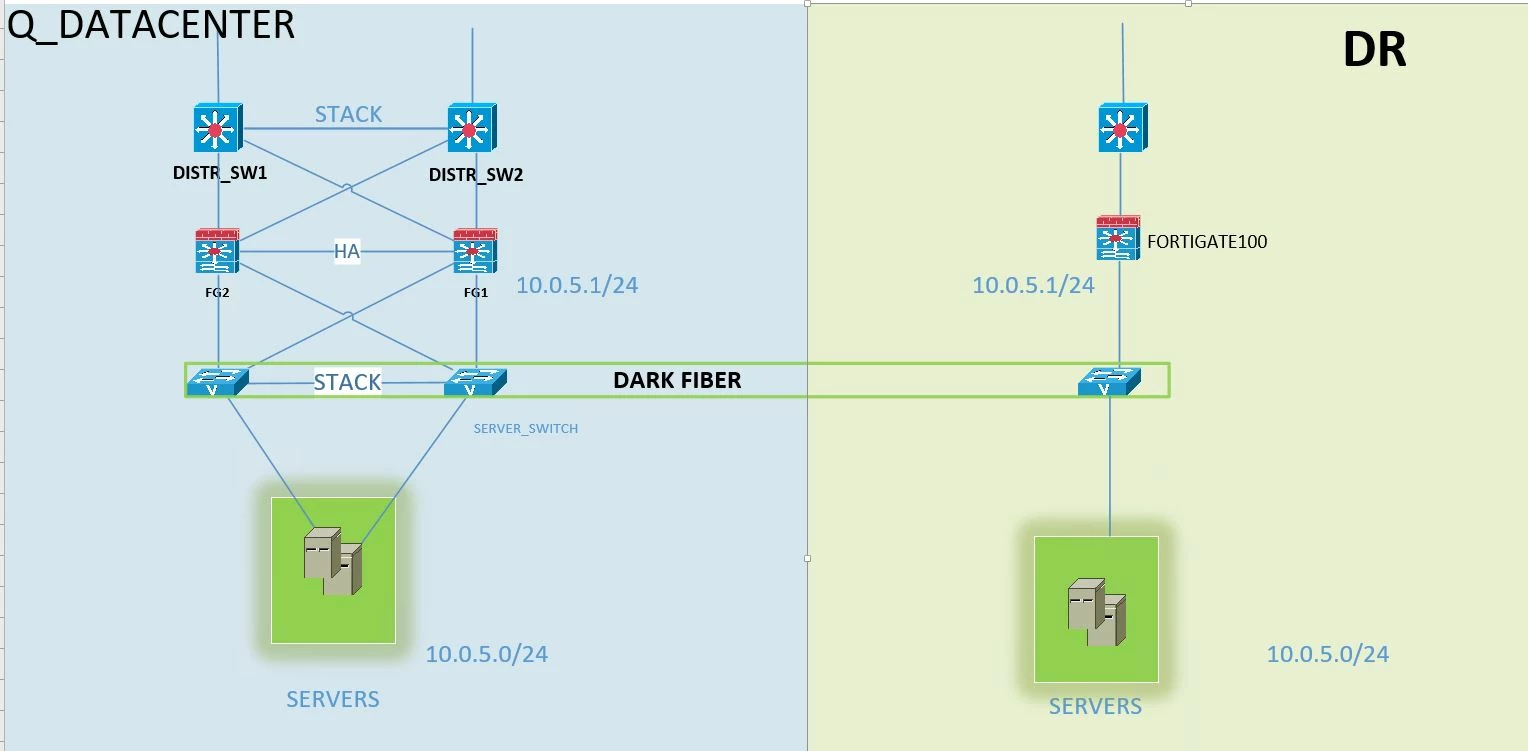

i have two fortigate which are  clustered itother via HA in HQ datacenter , they are gateway of servers . now i am going to build DR site which will be remote office and where  averything will be mirror of the main server room and these offices will be  connected  itother via  LAYER 2  DARK FIBER (in server switches) .  i need that when main office turned off for some disaster , DR office fortigate become gateway of my servers .
i thought that VRRP will be a best choice , but vrrp is not working properly . what do you think how can i build my topology , so that when primery office had down , DR fortigate will  become active , is it possible to cluster DR Fortigate and main fortigates together?  I have only one  DARK FIBER OPTIC which is  between server switches of HQ and DR  screeen topology.JPG

Hi Pantsu,
May I know if FG1 and FG2 are the same Fortigate model with the DR? If yes, you can take a look on the cookbook below. You may need a separate VLAN for the Heartbeat and connect all of the HA ports.
https://docs.fortinet.com/document/fortigate/6.0.0/cookbook/104761/adding-a-third-fortigate-to-an-fgcp-cluster-expert
You can also take a look on FGSP HA. It might be helpful on your  design.
https://docs.fortinet.com/document/fortigate/6.4.5/administration-guide/869218/fgsp-session-synchronization-peer-setup
