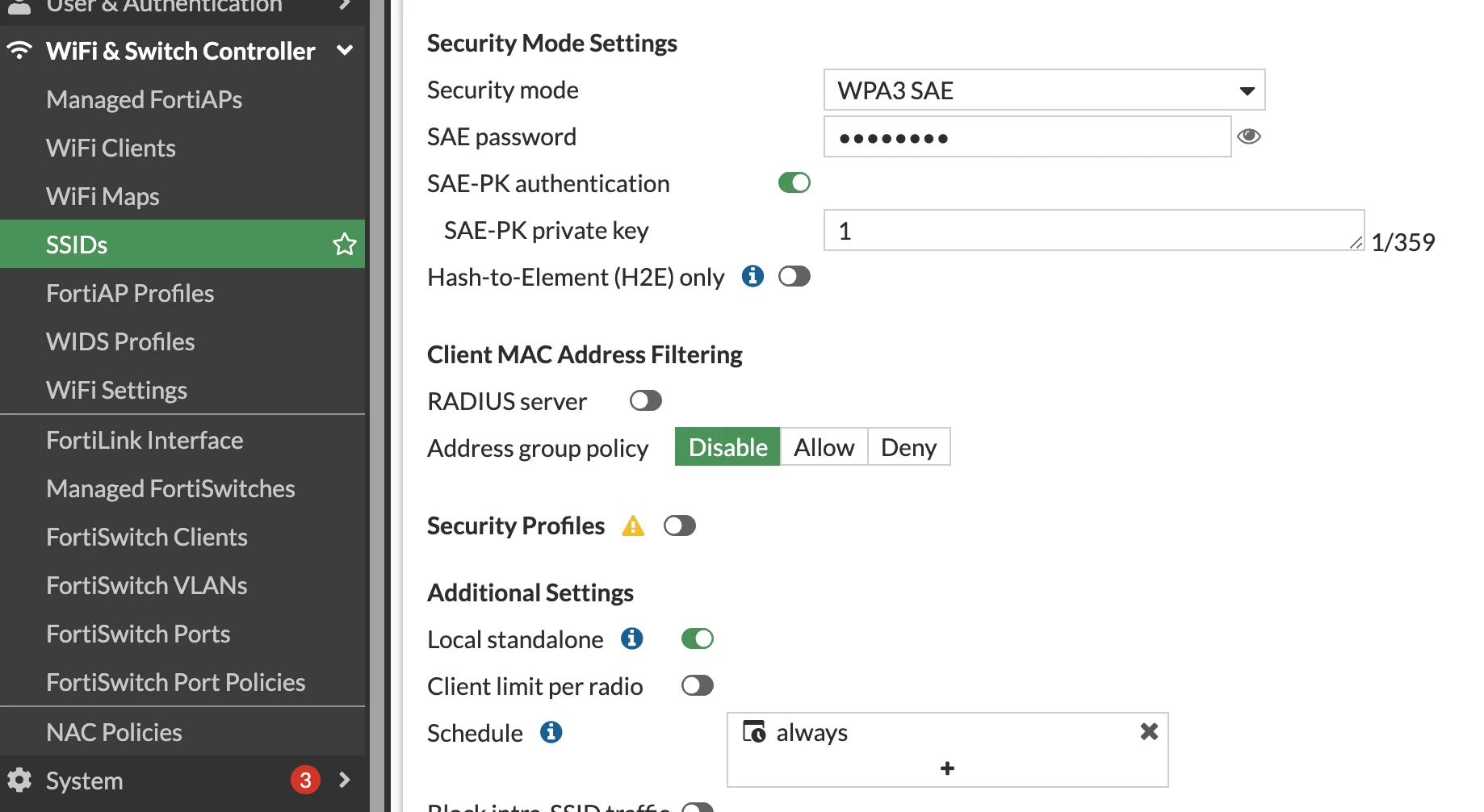

Hello there!
related link:
wpa3-enhancements-to-support-h2e-only-and-sae-pk-7-2-1
I have recently purchased Fortigate 40F together with FortiAP 231F, to set up a WLAN environment in my laboratory to test iot equipments. What I am interested in is "SAE public key" as introduced as part of WPA3 R3 spec, and it is introduced as a new feature since FortiOS 7.2.0.
My question is:
Has anyone ever tried to associate a SAE-PK-capable STA with a FortiAP(7.2.1 or newer) that support SAE-PK? If so, is there any tutorial simple enough to guide us through the first integration with regard to this SAE-PK authentication. For example, how to configure wpa_supplicant and what is the wireless sniffer capture like?
P.S:
Whenever I unclick the local standalone option, the SSID turns OFF automatically.
Somehow there is a rule between the "SAE-PK authentication" and "local standalone" parameter?
However, it can be found nowhere in any document.
Thank you very much, experts.

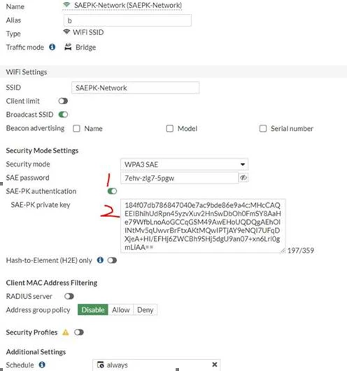

Best answer by grithnir
Through days of debugging and testing, it comes to a happy ending.
The story can be told in brief:
1. the latest fortiOS 7.2.4 has newly introduced a feature to check your SAE password and SAE-PK private Key at runtime, YOU SHALL NOT PASS unless you input the valid SAE password and SAE-PK private key PAIR.
Unfortunately, there's no such check and remind mechanism back in 7.2.3, so that
a wrong configuration will be activated down to FortiAp, leading to the FortiAP ending up
 with malfunctional BSS. That's why I have seen radio LED OFF.
2. How to generate these two attributes? Please refer to the github page https://github.com/vanhoefm/hostap-wpa3/
3. TAC fella said there will be updates in documents to deal with this stuff.
Cheers, Experts!

February 6, 2023
And whenever I unclick the "local standalone" option while SAE-PK is enabled under SSID setting, the FortiAP radio LED is sure to go off with this radio turned off.
Do you know what is the trick here? Is there any documents carrying this fact?

update.
grithnir
grithnirAuthorAnswer
Explorer
February 10, 2023
Cheers, Experts!
