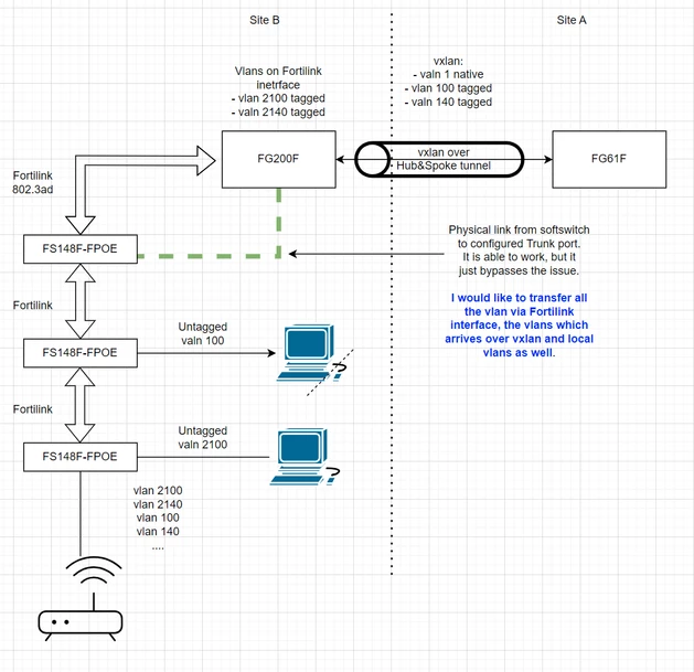

Hello,
I need some help in the following topic, I am note able to solve to mix external end internal vlans into Fortilink.
There is a FortiGate connected to 8 FortiSwitches via FortiLink interfaces. VLANs and subnets created on the FortiLink can be used on the switches without any issues. However, I need to be able to forward a VLAN arriving in a VXLAN to a specific FortiSwitch port.
I can pass the incoming VXLAN as a trunk through a software switch to a manually configured switch without FortiLink, and I can use the VLANs. However, in this case, I lose the switch controller functionality, or I have to establish a separate physical connection.
I would like to request assistance on how to switch a VLAN within a VXLAN to VLANs defined on FortiLink, or how to forward all tagged VLANs existing within the VXLAN to the switches via FortiLink.

Thank you for your help. I have problem with this solution, that I cannot add vlan on Fortilink interface to the Software switch.
