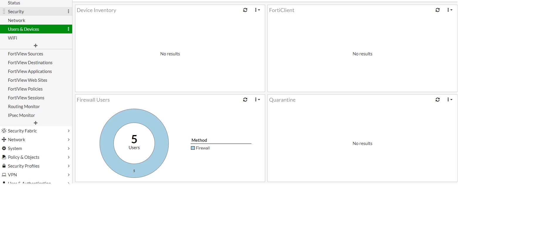

Hi Kvimaladevi,
Thank you for your quick response.
I checked what you said.
I can see 4 options.DEvice Inventory,Forticlient,Firewall users and Quarantine.
In Firewall users I can see 5 users using VPN Forticlient to connect.That is all I have.
All my computers start with a specific name ACL-DSK which I cannot see.

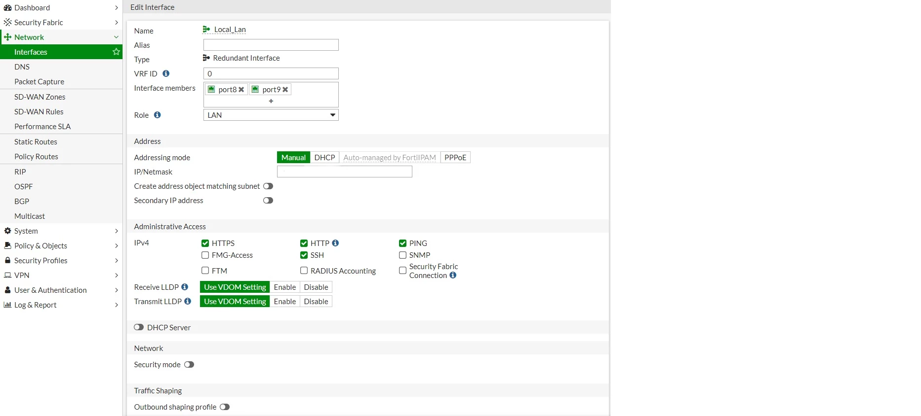

Hi Vishal Sahu,
I have gone through both documents but could not complete the steps.
I am using FortiGate 100F Firmware 6.4.9.
I cannot see Go to User & Device > Custom Devices & Groups.
My Device inventory is empty.
Now if I go to Network > Interfaces, there is no option to enable device detection.
Attaching screen shots

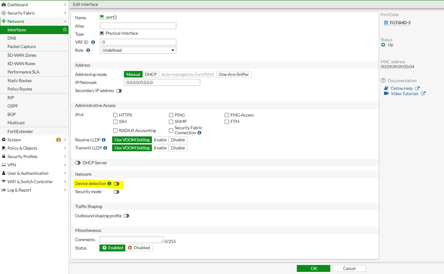

Hello Tazio,
You've to goto the interface configuration then you'll see the device detection.

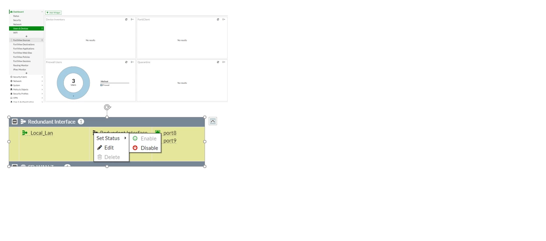

I have port 8 and 9 going to LAN.
If i go to interfaces i don't see Port 8 and Port 9 but I have port 8 and 9 as Redundant interface and when you edit Redundant interface you don't have that option.

btan
September 2, 2022
Hi Tazio,
Looks like a GUI limitation on redundant interface.
Try using CLI to configure:
config system interface
edit Local_Lan
set device-identification enable
