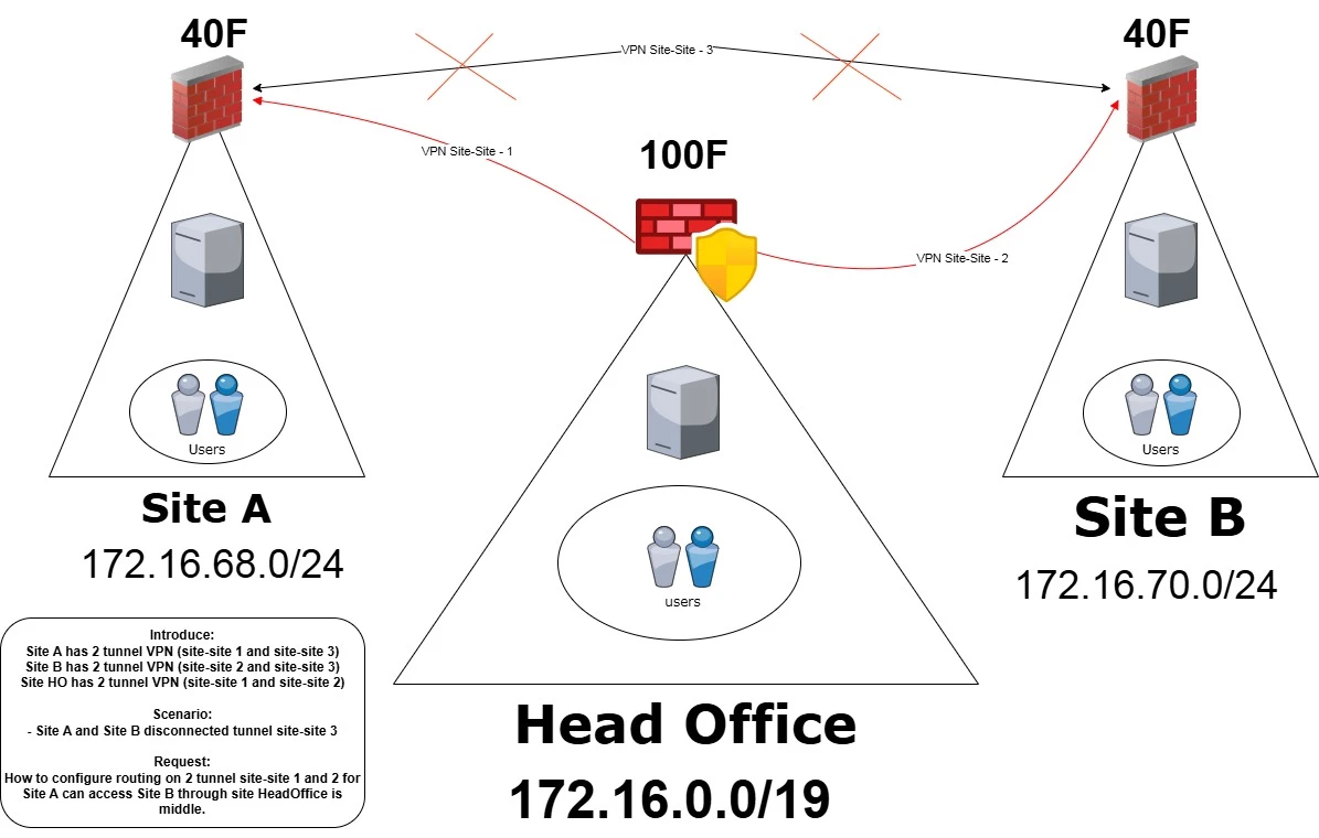

Introduce:
OS 7.4.6
Site A has 2 tunnel VPN (site-site 1 and site-site 3)
Site B has 2 tunnel VPN (site-site 2 and site-site 3)
Site HO has 2 tunnel VPN (site-site 1 and site-site 2)
Scenario:
- Site A and Site B disconnected tunnel site-site 3
Request:
How to configure routing on 2 tunnel site-site 1 and 2 for Site A can access Site B through site HeadOffice is middle.

Have you tried by just adding the two static routes through ss1 and ss2 with higher distance?
Doing so should force your FG-40Fs to use ss3 tunnel when its up, and once ss3 is down its route is removed and the FG-40Fs will use the remaining routes ss1 and ss2.
You will also need a firewall rule on FG-100F to allow traffic from site-A to site-B and vice versa.
