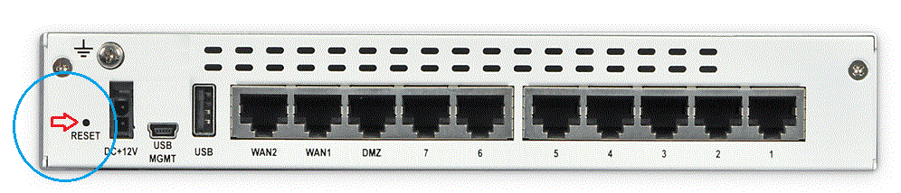

i had a problem,i lost password for my fortigate 60D , i tried follow several tutorial from this forum to restore the device to factory default, all the the tutorial use console to reset it,but my Fortigate 60D dont have console port, so how can i restore my device use usb management.

    Accessing the " virtual console" port on the 60D requires the use of FortiExplorer. Instructions are detailed in this SysAdmin Notebook document. Instructions for resetting the password should be the same as those found here at step 6 through 9.

    i have tried it,but after reboot, it appear message failed to boot default firmware in device, what must i do to solve this?

    If you are unable to use the FortiExplorer " virtual console to access the boot menu (BIOS menu) you likely have no choice but to use the reset pin hole on the back of the 60D (next to the power connector). I have never tried this myself and not sure if pressing/holding it in will cause a) factory reset (wiping the config), b) format boot device, c) factory restored firmware. I suggest opening a ticket with Fortinet support, but I am going to guess they would want you to use the reset pinhole.
