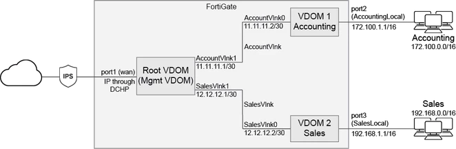

I am a user of Fortigate 7.4.4. I have an architecture based on a root VDOM, where my WAN connections arrive, and then interconnection links with my child VDOMs (as shown in this diagram visible in the Fortigate documentation).
4b71aa7a1dc7259b927ed41ff8afe22f_Topology_Inter VDOM Routing Ex_Internet access_Updated-01 (1).png

If you're hosting your customers with VDOMs, they/you don't want customers sharing the same public IPs. It might/would cause problems when they need to get security audits like PCI-DSS and PEN tests required for the certifications.
You need to get additional block of public subnet(s) from your internet circuit provider, then assign it to the Vlink/npu-vlink between root vdom and the customer vdoms in the diagram. The link subnet can be as small as /31 if you use p2p links and static routing but most ISPs provide like a /30, /29, /28 and above. You can split a /30 to two /31s and use them for two VDOMs if you want, like in the diagram.
