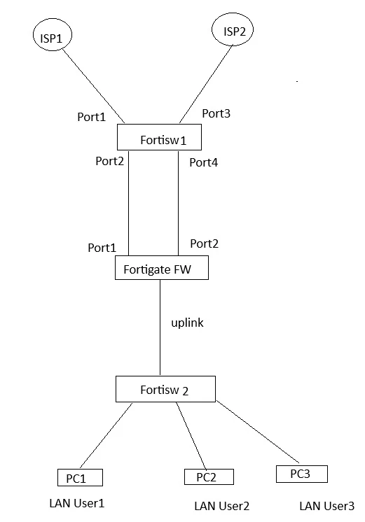

Dear all,
I want to know for the sake of knowledge as i have to implement this scenario at my small office.
How can I manage two fortisw (LAN and Internet facing Fortisw) from single fortigate firewall.
Can I manage using this diagramdia.jpg.

Hi,
It is possible. You need to setup 2 fortilink interface in this case.
port1 and port2 are part of aggregate link so the agg link needs to be enabled with fortilink and similarly the uplink port on FGT will be another fortilink interface
