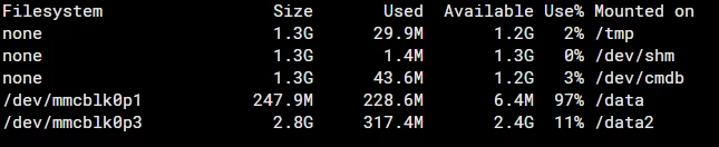

Hello.
I want to increase fortigate disk capacity. (/data)
The disk is full as shown in the picture below.
(The equipment is Fortigate 40F, and the version is v7.0.9_build0444.)
How can I do this?
Please help me, Thank you.

Jackie_T
August 20, 2024
The flash memory is built in, there is no way to expand it.

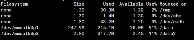

Coworksit1
August 21, 2024
Thank you for your answer.
Then I want to secure the capacity of /data
(It's currently 97% 91%, so I think we'll reach 100% soon.)
Can you tell me how to do that?
If the log is stored in /data
I just want to keep it for a year and delete the rest.
Please check and reply.
Thank you.
Jackie_T
Jackie_TAnswer
August 21, 2024
Hi,
If you need to retent logs,you may consider using remote storage instead (fortianaylyzer, syslog, forticloud....)
Logs that store in memory will be gone every time you reboot the device, is never a good option for long term logging.
Furthermore, memory logging will used up your device memory especially for small model which already have limited memory.
