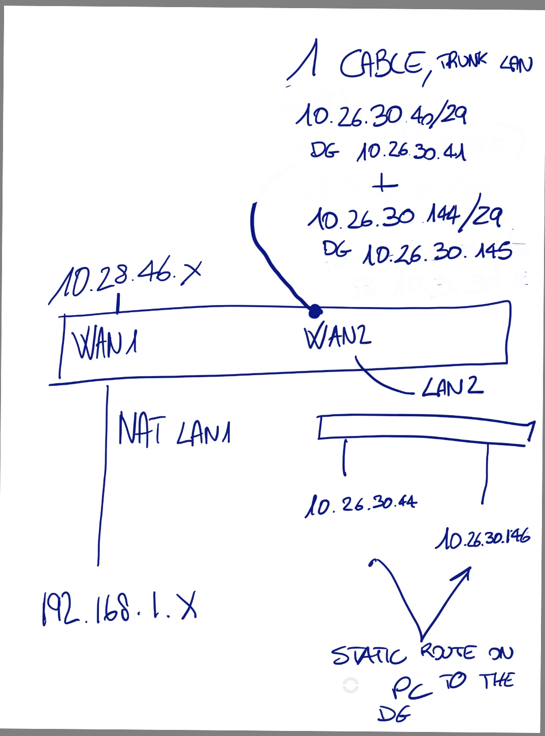

May 14, 2024
I took the time to draw it and I'll share it, thank you in the meantime

How it is possible to use 2 different IP/DG on WAN2 interface?
outside there is another Firewall that have the 2 vlan

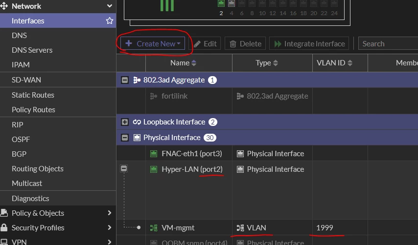

Can i use WAN2 port like this
or i have to use a port in trunk mode like this (in this example I had not yet added the two VLANs)

ok one port can not be a trunk on a fortigate. You would have to create two vlan interfaces that are tied to WAN2 on your FGT. Then you have to have a default route and static routes for what you need.
However you can only have more than one default route for redundancy (and that only as long as you don't use sdwan). The metric (prio/distace) will set which default gw will be used. In case you use sdwan you just need a default route via sdwan and sdwan does the rest for you.

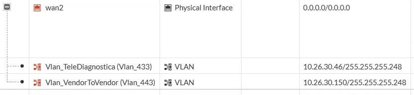

May 14, 2024
ok thanks, I'll try it as soon as possible, for now I've configured them like this
sw2090
May 14, 2024
yes that's what I said. Two vlan interfaces tied to WAN2 and both have an IP out of the corresponding VLAN.
