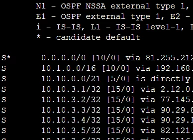

Hello,
I'm searching how to clear or purge routing table. A few days ago we were using a IP Adr Scope (10.10.3.0-10.10.7.254) for our IPSEC Forticlient user and we did some change to a new scope (10.10.24.0-10.10.28.0).
But in the old IP Addresses remains in the routing monitor list as static addresses and in conflict with some we now need.
How can I do a purge or clean the routing-table ?
Regards

    I try and follow the ? help to set the command line for Interface and route
    diag  ip route delete <intf> <route>
    Command fail. Return code -1
    Not possible to delete one route and i've more than 500 to delete (Ipadr Scope).
    Does a Fortigate restart will solve the issue ?
    Regards
    emnoc
    March 18, 2021
    yes obviously a restart will clear teh rib but what is your exact issue? It does not sound like a rib issue. What does
    "get router info routing all " show you ?
    Also , does it match "diag ip route list" ?
    ken Felix
