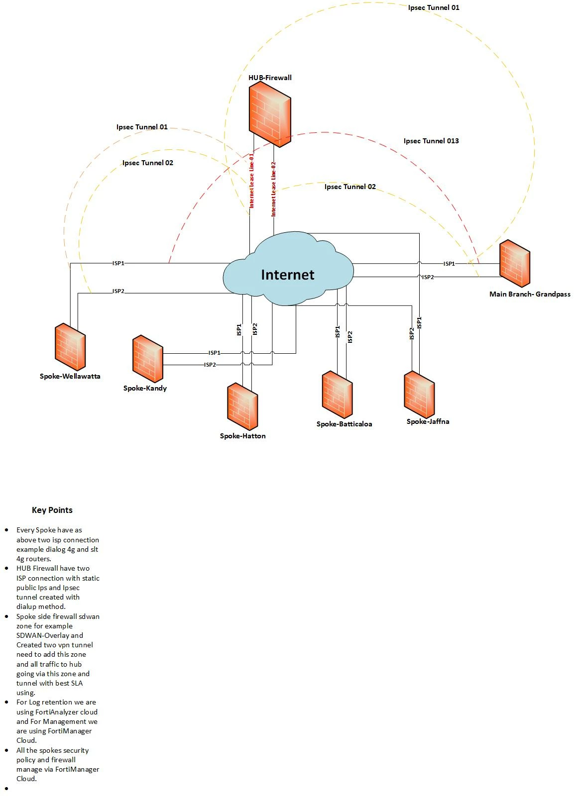

June 12, 2025
This is my topology and so Tunnel 3 for used sttaic route tunnel 3 separate tunnel in for NAS server access i need when tunnel 3 goes down need to automatic disable this sttaic routes
Toshi_Esumi
June 12, 2025
It doesn't show the topology of the BGP domain. Which ones are BGP neighbors?
