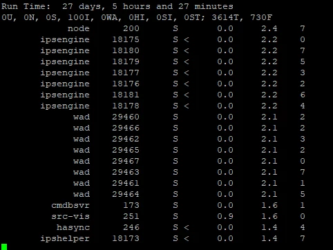

My box FGT100F ( in HA Cluster Active-Active ) it shows 72% of memory use, I wonder if there is any bug on 7.0.5 firmware because my configurations it is very bit regard UTM feature.
I have only three IPS profile and my traffic is very low achieves maximum 15K sessions
look at the screenshot below, IPS is always at the top of memory consume but I don´t understand because my traffic is very low regard IPS, APPControl or WebFilter. I had open a ticket in support but they few help me.

Hello, link in attached.
Yes, it fall in conserve mode as crash log. after that I disabled somes feature and IPS profile so the memory down in 72% to 62% but I still think that value is high regard this environment.

I´m trying kill wad process but it always auto restart after some times. I already disabled all proxy feature so I wonder Why wad process always run.

Please share the outputs below:
get sys perf status
diag hardware sys mem
diag sys top-mem 20

Hello everyone, I decrease IPS profiles, disabled some feautures and reboot at the box.
After that memory throughth from 72% to 64% , I will go keep it monitoring.
