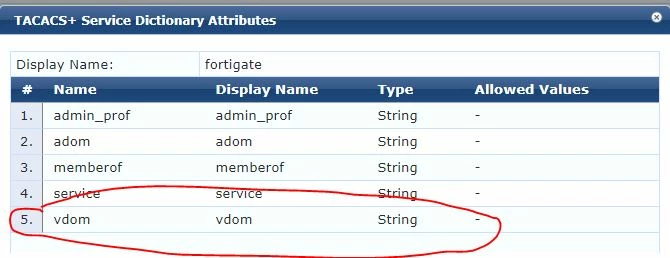

I use tacacs+, not a radius, do you know the attributes for vdom in TACACS+ Services Dictionaries?
I try put vdom like the photo:
but no luck.
thank you
Markus_M
August 17, 2022
Hi Mohammad,
based on this:
https://community.fortinet.com/t5/FortiGate/Technical-Tip-Access-using-TACACS-authentication-with-admin/ta-p/196361
I would guess the values are simply what the FortiGate config has to offer.
vdom = vdom-name, e.g. root. Rest as per article.

pminarik
pminarikAnswer
August 17, 2022
"radius-vdom-override" has "radius" in its name because historically TACACS+-based login has not supported dynamic VDOM assignment.
This has however just changed in firmware 7.2.1, where the new feature logged under ID 803326 has implemented this.
ref: https://docs.fortinet.com/document/fortigate/7.2.1/fortios-release-notes/743723/new-features-or-enhancements
Vendor-Specific Attributes (VSAs) can be used with TACACS authentication and authorization in wildcard system administrator access to FortiGates from browsers and SSH. The new VSAs allows the FortiGate to perform group matching, and overwrite VDOM settings under system admin.
The expected attribute name is simply "vdom" .
Keep in mind that this will not work in any other version.
Mohammad
MohammadAuthor
Visitor III
August 17, 2022
Hello pminarik,
Thank you too much for your help and the information.
