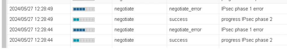

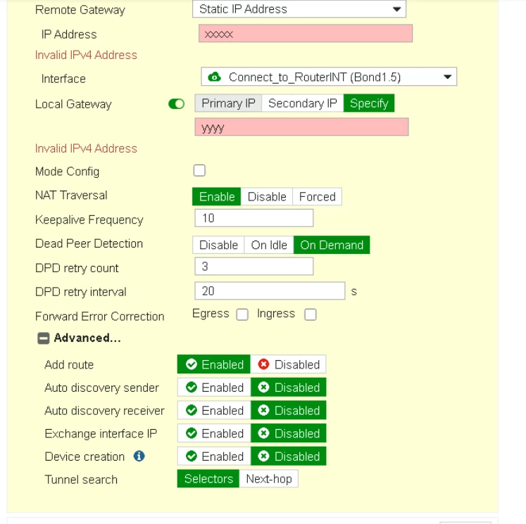

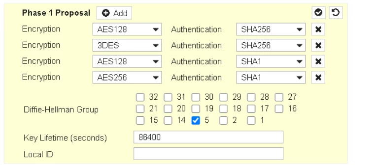

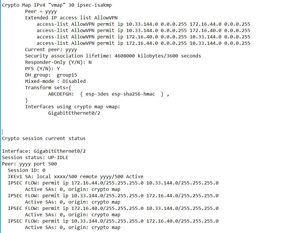

I set VPN between FGT v6.4 & Cisco2911
on FW display phase1 done but phase2 down
so when I check event VPN, result is phase 1 error
On cisco, status is UP-IDLE
for some reason, I had to hide the information
look forward to the help
RT config.pngshow crypto RT.pngnetwork.pngauthen.pngphase-1.pngphase-2.pngVPN event.pngdiag FW.png

Hi @quynhln8 ,

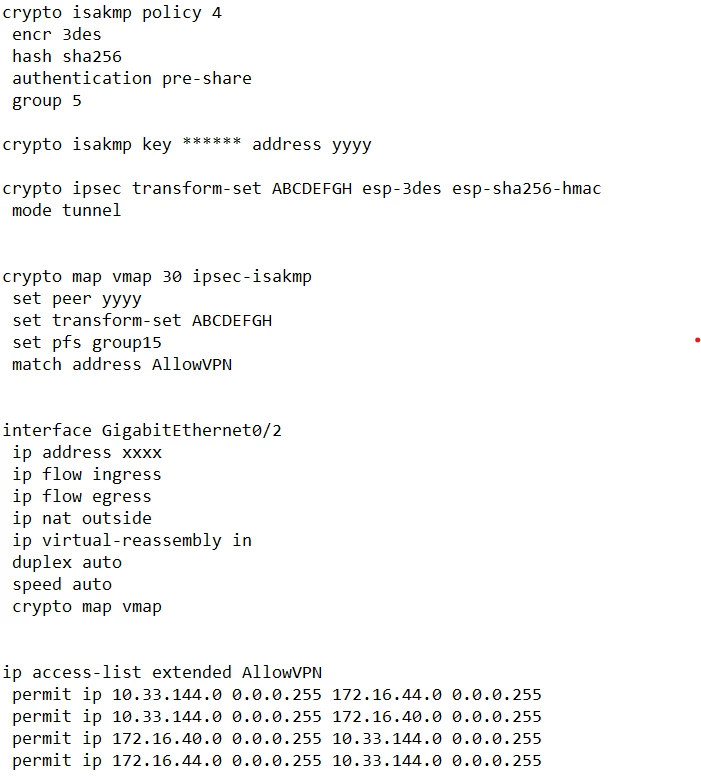

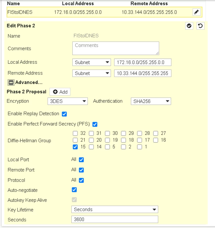

I can see that in the phase2 you have configured lifetime 3600 on the ForiGate side but on the Cisco I do not see it (default should be 28800 if I remember correctly).

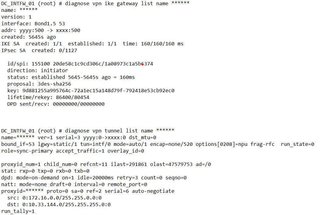

You can run the following debug to find out why the phase2 is not coming up:
diagnose vpn ike log-filter dst-addr4 <remote-peer-IP>
diagnose debug application ike -1
diagnose debug enable
Note: Starting from FortiOS 7.4.1, the 'diagnose vpn ike log-filter dst-addr4' command has been changed to 'diagnose vpn ike log filter rem-addr4'.

in Cisco RT, I show crypto map, life-time is 3600

This is debug follow your guide, do you see any error anywhere
I dont know how to insert .txt file
https://drive.google.com/file/d/1DqA6JIPThL791e4tUiP1HkQFMTJ-ZvWt/view?usp=drive_link
fricci_FTNT
May 29, 2024
Hi @quynhln8 ,
It looks like that the Cisco is not choosing a proposals for some reason, then it sends a notification to the FGT and the FGT deletes the corresponding phase 2 Security Parameter Index. Phase 2 negotiation then restarts again:
2024-05-29 17:19:20.066987 ike 0:ABCDEFGH:159258: notify msg received: NO-PROPOSAL-CHOSEN
2024-05-29 17:19:20.067013 ike 0:ABCDEFGH:159258:ABCDEFGH:2762615: IPsec SPI 52416064 match
2024-05-29 17:19:20.067019 ike 0:ABCDEFGH:159258:ABCDEFGH:2762615: delete phase2 SPI 52416064
Please try to choose a different proposal and check if the anti-reply is also enabled on the Cisco side (if available).
https://community.fortinet.com/t5/FortiGate/Technical-Note-Explaining-IPSEC-Anti-replay-and-preventing/ta-p/192424
Once done, please launch the debug commands again and then reset the IPsec tunnel on both ends, so you can see the whole phase1/phase2 negotiation outputs in the debug (you can use "diagnose debug application ike 255" instead of -1).
Also on phase2 config on the FortiGate side you configured 172.16.0.0/16 and on the Cisco side you configured 172.16.40.0/24 and 172.16.44.0/24.
Can you try to configure two separate phase2 selectors on the FortiGate side as well, please.
You may find the below old post useful:
https://community.fortinet.com/t5/Support-Forum/Site-to-site-VPN-Fortigate-5-4-and-Cisco-NO-PROPOSAL-CHOSEN/m-p/33192

The thing is FGT display phase1 up, phase2 down, but when show VPN event, phase2 success, phase1 error. This problem is very confusing

It shows that they have different phase2-selectors; kindly match their phase2-selector and do not add it at once as the SPI will be different.
Kindly see this document for further information.
https://docs.fortinet.com/document/fortigate/7.4.4/administration-guide/666100/ipsec-vpn-between-a-fortigate-and-a-cisco-asa-with-multiple-subnets

May 30, 2024
tks every one, it's already working
