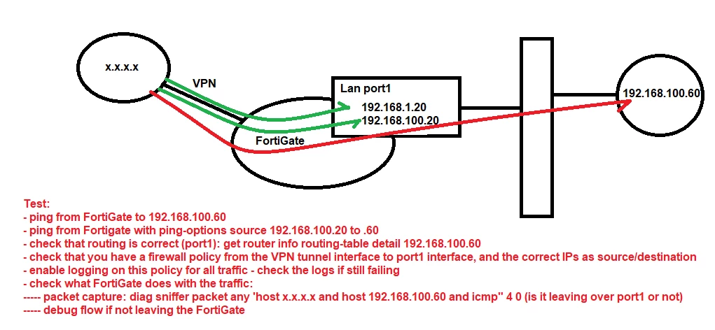

Please correct the above diagram if wrong.
"Hairpin" usually refers to a NAT (and a VIP involved).
There is no NAT needed in your policy and no VIP mentioned in your description

Thanks Alex, that diagram is correct and there's no NAT enabled on the policy but not sure what you mean by VIP on this ? I know what a VIP is but not sure where it's relevant on this scenario ? I'm hoping this is what I'm missing and I've just mis-understood how to set this up ? I've tried a ping to 100.60 from the 1.20 interface and that doesn't work so obviously there is no traffic going between the IP's on the same interface.

AlexC-FTNT
Feb 28, 2022 2:14 PM UTC
The image has quite some troubleshooting steps.
Please follow that and attach some relevant output if you need, or open a support case. The verbal confirmation of these tests that you performed is not sufficient to guess the problem. I'm quite sure that you missed a policy lan>lan or VPN>lan or lan>VPN... but who knows, maybe there is more - I also don't have a configuration file to verify, therefore guessing is not very accurate :)
(if there is no VIP, then there's something crossed off the list of possible issues)
